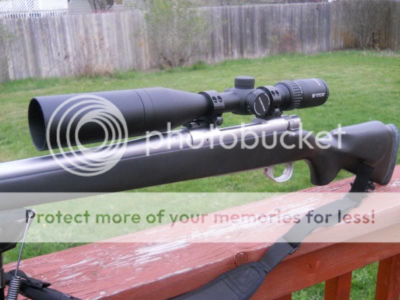

Well I finally got her all buttoned up and ready to rock 8)
6.5x55mm Swedish Mauser - SAAMI spec chamber
1) Action - Stainless Howa 1500 LA - trued, lugs lapped, bolt faced honed to fit 6.5x55 rim, and bedded with Devcon, factory trigger safely set at 1.25 lbs and timed to action for smooth cycling.
2) Barrel - Shilen CM 1 in 8" twist, #3 contour, finished at 22" - Bead blasted and finished with high temp (2200 F) automotive exhaust header clear coat.
3) Stock - Weatherby Vanguard factory synthetic - cut down and installed new 1" Limbsaver recoil pad for 12.75" length of pull, reduced height and width of cheek piece, removed checkering and re-finished with high temp automotive "metallic black" paint and clear coat. Barrel completely free floating with "double-folded dollar bill" clearance all around.
4) Optics - Newly designed Vortex Diamondback HP 4-16x42 with glass etched reticle, ed glass, and side focus. Perfectly leveled to base of action with Wheeler Professional Scope Leveling kit.
5) Optics Accessories - Weaver Rem 700 two piece bedded with Devcon Epoxy. TC Dimension rings, Low height, lapped and torqued to spec
6) Misc - 100 rounds factory Lapua ammunition with 108gr Scenar. Bipod. Sling shortened to fit.
Recoil pad looks a little rough by comparison to the rest of the rifle because I still have to "shoe shine" it with black Turtle Wax.
Other than that, we just got to do a quick barrel break-in then start letting the little guy send rounds down range. I ran through the paces and set it up just the same as I do my own rifles to ensure top level accuracy and reliability in the field. Should serve him well for years to come :)
