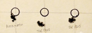

Second time out my target was not any better . I'm going out to find some different amo today , like you hopping to find some amo that gives better groups . How big are your circles?
He said the circles were .75 inch. A piece of advise to both of you, try cci standard velocity. Wal mart has it in 50 rd blue boxes in my area. It eventually grouped around an inch for me.
When I started down the accuracy rabbit hole I tested 3 bricks of everything and kept records that I still have.
I've tried at least 20 different brands & lot numbers of various ammo, including 3 or 4 of CCI stuff. The above target I was shooting the somewhat "best" of the bunch.
I have probably north of 1000 rounds down the barrel now, & it seems the big flyers are less at this stage. To call this a "Target" rifle is down right deceiving....
So just for the halibut, I shot four 10 shot groups at 100 yards. No real concentration, just put the reticle mostly in the middle & rip off ten. Wind was a little switchy, & more than I wanted, but groups were better than expected.
Two groups on the left were with the Federal.
Top one measures 2 7/8"
Bottom one is 4 7/8"
9 went into a flat 3"
Two groups on the right were with CCI Tactical AR ammo.
Top one measures 3 1/4"
Bottom one is 3 1/2"
9 went into 2 1/4"
The white section in the middle measures 2.50"
Out to out on the red is 4.00"

I understand what you're saying, but I'm pretty sure the shooter isn't to blame here.
Springfield's accuracy guarantee:
Springfield Armory stands behind all Model 2020 Rimfire rifles and promises rock solid performance with a three-shot accuracy guarantee. Every configuration is guaranteed to shoot 1” or less at 50 yards with quality match-grade factory ammunition, in the hands of a skilled shooter.
This one is lucky to shoot a 2 shot group into their accuracy standard. The majority of my 10 shot groups were shot 5 at a time. Load and shoot 5, then load & shoot another five at the same bull.
I'm shooting off my Hart rest with a cordura bag, rear bag is a Protektor Doctor bag filled with heavy sand. I'v tried hard holds, soft holds, no holds, played with action torque, played with barrel pressure at the tip, even loaded some single, one at a time by hand.
I've hard cleaned it with a brush & solvent, I've stroked it with JB, and I've look at the bore with my Hawkeye. Bottom land has a couple divots, but I don't think that plays a role.
