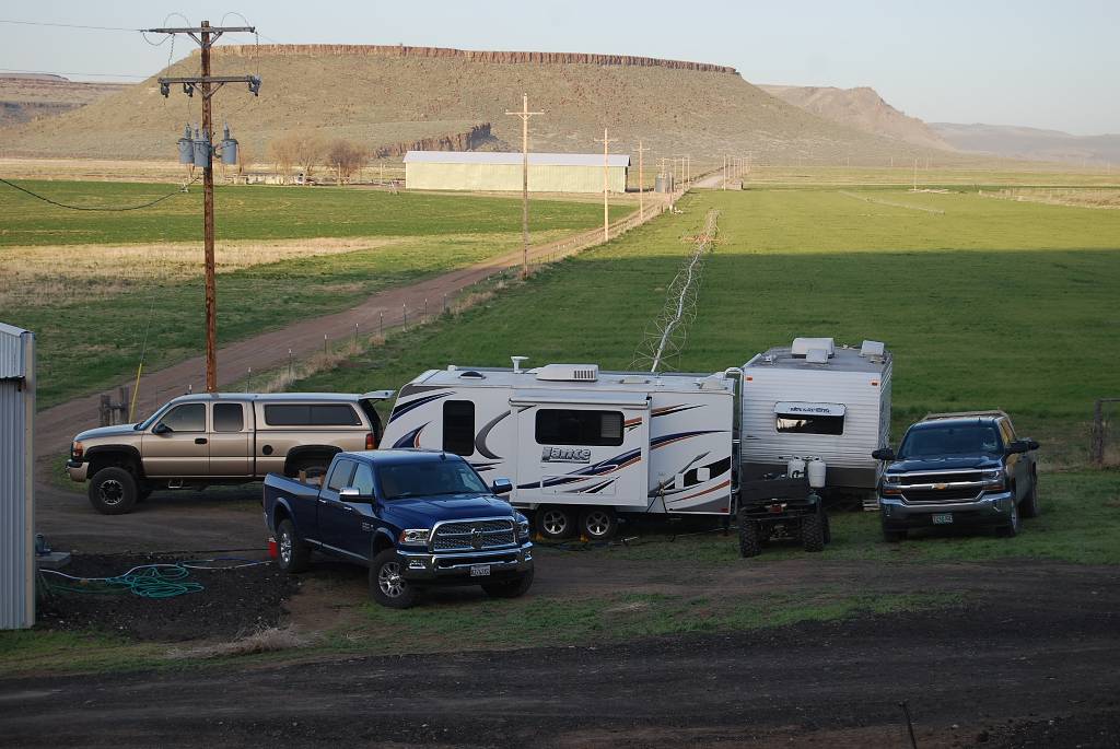

Good point there. We tackled the problem from another angle, but we're fortunate to have cooperative rancher friends within a three hour drive from home. We usually go for 10 days to two weeks, stay in our own trailers on ranch property, hooked to water and power, all for no charge, as the landowner feels we're doing him a favor and not paying over $50/Acre for the cabbage poison.

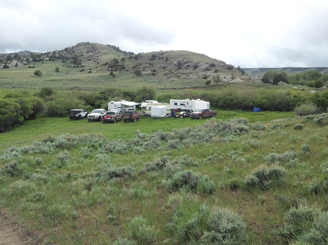

We all do what works for each of us, but geography is what it's all about. I confess to moving to where I now live just shy of 50 years ago, primarily for the hunting/varmint shooting. No regrets.
Nice setup - having water and power is a real plus. You are right about it being all about the geography.
I am fortunate that I have access to a quite a few ranches for gopher shooting within 20 to 60 minutes of my place, I am spoiled. I usually get out a couple of times a week which is why I get in so much 22 LR shooting.
Another geographic thing I have going is that I have a daughter, and my wife has numerous relatives that live in central Montana - PD central. So every visit is a PD shoot for me.
There is a small group of us who do a similar setup as you for a PD camp in Wyoming each year. No water or power though - just lots of PD's.
