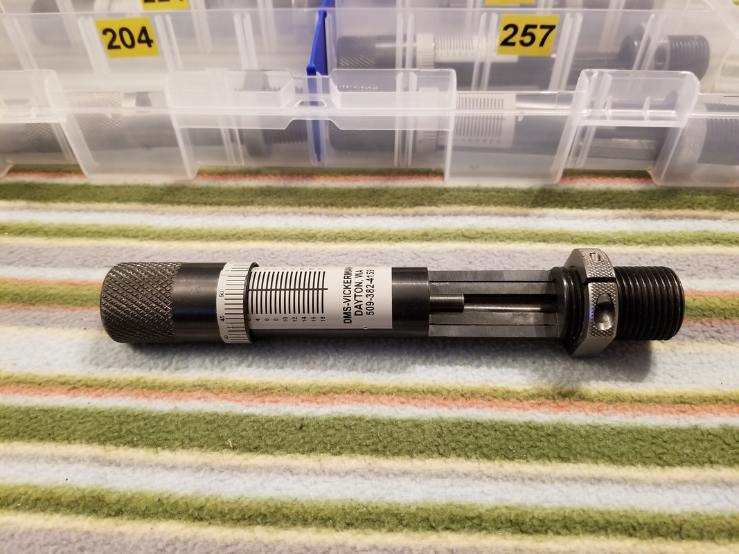

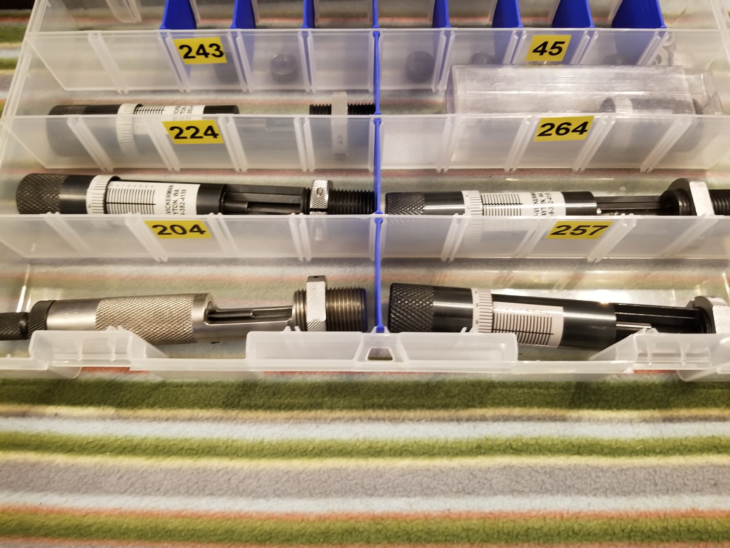

I started using Vickerman seater dies when I began loading 17 & 20 Caliber bullets. Just makes it a lot easier for my old hands. LOL Like them so much that they are all I use now. I still size new brass and chamfer before first loading. Not saying this is the best way just saying it works for me. No problem with flat base bullets.
Safe shooting
Doug
