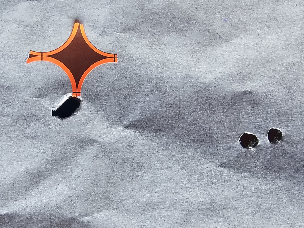

I bought a shouldered Krieger that was chambered & fit for an Origin in 6 creedmore and it fit perfectly and shoots well.

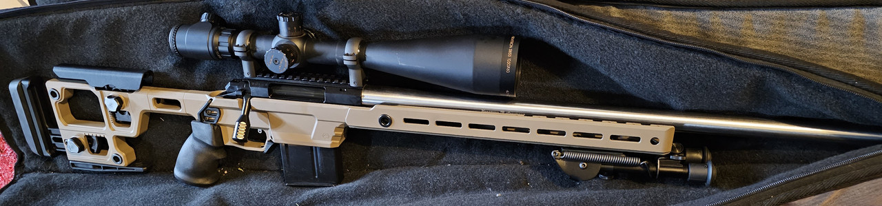

I have the Solus action in 6.5 CM and 6.5 PRC. The bolt is a 3 lug with 60° throw. The 60° will make it a harder lift. I have no complaints. In a few months I'll be able to compare the Aero Solid with the Coup De Grace. I just bought 2 today. Midway has them for $899. On top of that they gave me 20% off for a birthday discount. Bday is in 2 days.
I'll be building a 6 Dasher and a 25 x47.
