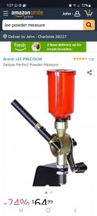

I understand there is a new model that uses a brass drum instead of plastic and retains the "wiper". Anybody compared them to the old model?
I had to buy one of these to try out as had heard good things. 20 bucks!
Yesterday I loaded up 30 rounds of 30-06 with Big Game in 50 gr range. Took 10 throws to get it dialed and the last 20 throws were all within 1/10th of a grain weighed on my tuned m5. Most of them were dead nuts or less than a 1/10th variance. Amazing! Never touched the trickler. My scale will move with one grain of varget.
The BigGame is a spherical powder. Now to test it with some extruded.
Do you have a link to the specific model that you purchased? Thanks!
That's what I've got now. Post #20.
