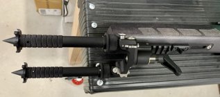

I liked the looks of this WOOX stock and the fact that it’s a full aluminum chassis for strength but with wood dressing for a more traditional look. I didn’t know what to do with the pic rail on the butt of the stock since I don’t use rear monopods so I fashioned a custom aluminum pic rail cover to turn it into a nice bag rider on the rear end. Also mounted a swivel stud up in the front of the butt rail since i don’t like side mounted slings. I placed the swivel stud in a spot where it does not need to be removed when using a rear bag. It’s drilled and tapped into the front of the pic rail.
- BAT HR receiver with Lapua bolt face
- Bixn’ Andy TacSport Pro trigger
- WOOX Exactus stock with CIP+ M5 cut
- Hawkins M5 bottom metal with 3 round Accurate mags.
- Hart 1 in 10” twist barrel @ 26”
- Tactics muzzle brake
- Atlas CAL Gen 2 bipod with custom spike feet

Yeah the fit and finish is excellent. The machining is perfect fit as well. Didn’t even have to shim or deepen the inletting on the bottom metal. Exact perfect depth straight out of the box for proper mag feeding.
Didn’t even have to modify receiver screws as they all had perfect full amount of thread engagement. They definitely have the inletting down perfect for Hawkins bottom metal
The only thing I had to do for inletting on the BAT HR was mill out a little spot out on the for the retaining screw that holds the side bolt release in the receiver. Everything else fit up perfectly. They say you don’t need to bed it but of course there’s no way I’m not bedding it because there’s no support on the sides of the recoil lug for torsional resistance.
The one big negative was that the Exactus comes with a side mounted QD cup for sling mounting in the rear, but no sling attachment of any kind in the front. Doesn’t make any sense to me. It has an Mlok rail on the forend so I installed a sling mount on it and since I can do my own work, I drilled and tapped a swivel stud in the rear as well. Other than that mess up on the design, it’s a very good stock. Overall I am very happy and will probably be trying some of their other models in the future.
