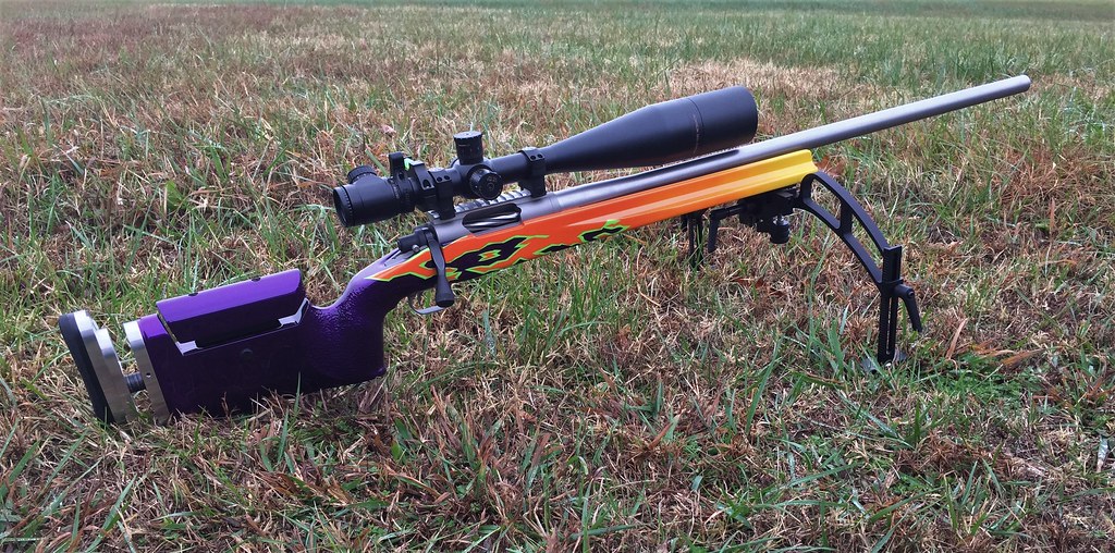

I absolutely love to shoot. I've been bitten by the long range bug in a big way. I have never reloaded a single cartridge. I have a F-T/R .308 chambered for the 200.20x's. I have a good supply of projectiles and I have Lapua brass. I have a decent shop setup at home which I have been working in and on for 25 years. Over those years I have bought and replaced nearly every machine. Some of them multiple times. I'm trying to avoid that as much as possible in this endeavor. I have a good working knowledge of machines and mechanical principles in general. I run a body shop and have for many years. I don't want to buy everything multiple times if I can avoid it. With that being said, I do not have an unlimited budget. I do like to have nice(r) equipment.

The rifle...

The rifle...
