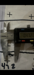

Smallest 100yrd 5 shot group
Confirmation of a hunting load in 30-06

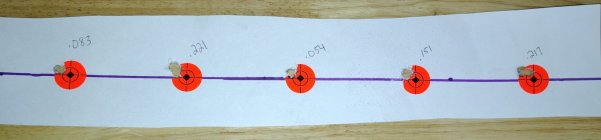

Remington LA Krieger barrel, shot off of sandbags. 16070339961655306425584376203700.jpgA couple 3 shot groups, same LA hunting rife Brux 6.5-284 powder tuning.
Over layed would be 6 shots still in the .0's. Shot off front restResized_20231002_105646_1732036265976.jpeg

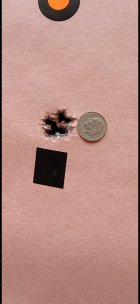

Here's my 5 shot group last fall working up a load for my avengers just had coated them with HBN can't pronounce it can't spell it that will have to do hope to get it better this year still playing with it
