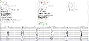

According to my CED M2 chronograph, about 2650. I mistranscribed the load in my post, which was actually 44.6 gn of Precision. I backed off from 45 gns because primers were cratering. Vels were 2610 @ 44 gns and 2670 at 45 gns.
According to Shooting Lab, the vel should be 1307 @1000. Quick Target is giving me 1257.
One of my problems is that I only have 150 of these bullets left and no one has them in stock. If I use 50 experimenting, I'll only have enough left to shoot one match.
I'm thinking of trying a load using 748, which (of the powders in my inventory) seems to give the best velocity within pressure limits.
I think that 1257fps (M=1.12) is too low for the Shotmarker to detect reliably.
Most likely too slow. I pushed them at 2875 out of a 32" to get ~1400fps on target at 1000. 1300 is getting into the territory that shotmarker won't register
Agreed. This is why I plan to try 748, which while not the best powder is one that should give the needed umpf within pressure limits.
One other issue is that ShotMarker was reporting velocities around 1600 fps at 600 yds. This is about 150 fps less that what Shooting Lab predicts. Now, in discussions with other shooters on the range, they say that the Shot Marker generally reports velocities lower that what is predicted. In any case, you can't use it for anything except shot-to-shot comparisons.
Does anyone have a BC table (BC vs vel) for the 169s rather than just the single (.527) value given by Sierra?
I tested some loads at 1000 on Saturday and found that while I could hit the metal gong at 1000 and hit a specific patch of dirt on the berm, I couldn't get the shots to register on the ShotMarker system. (I was loading 43.6 gn of Precision Rifle in a Lapua Palma .308 case shooting from a 26" barrel.)
Need to know what you're Density Altitude is, as that's a big factor.
The load I've been running recently for these 169's is giving me an average MV at 2767 fps and at an Density Altitude of 125 ft. my Strelok Pro gives me a velocity at 1000 yds of 1279.4 fps. When I change the DA to 4000 ft. It shows a velocity of 1404.8 fps at 1000 yds.
'Bout as close to sea level as you can get and have dry feet.
Hmmmm??? Well, that may not be much help as the DA can be very different from altitude above sea-level. For example, as you can see in what I posted above, the DA is at 125 ft., but the altitude above sea-level is at 880 ft. The DA is based on barometric pressure and humidity.
I have a feeling that Quick Target number of 1257 is probably close to the number you can expect with your load. ¯\_(ツ)_/¯
I plugged my current conditions into the NWS Density Altitude calculator and got 2254.2 ft. Since I don't understand the distinction, I can't comment on the accuracy of the answer.
At the range on Saturday, it was close to 1597.5 ft because it was 10º cooler.
My shotmaker velocity was 1409-1416 fps for three strings at 1000 yds Sunday. Our range is at 4100 ft. the temps were low 50s to high 60s. I am not of sure of my muzzle velocity, need to review my Magneto Speed logs. I am loading 43.3 grns of Varget in large primer Starline brass out of a 30 inch barrel. No trouble picking up the shots at that speed.
I ran this load in QL and came up with 2679 fps. Then I ran the ballistics at 4100 ft, 40% humid & 50ºF and it was predicted right at 1400 fps @ 1000 yds. I then changed the atmos data to 10 ft, 80 % and 70ºF and the 1000 yd velocity dropped to below 1200 fps. What a difference the atmosphere makes. :D
BTW: To give you and idea of the difference in Density Altitude and actual altitude above sea level, the altitude at my range is at 880 ft., but the conditions given the temperature and humidity, the DA calculates to 210 ft.
Yes, indeed . . . atmospherics like Density Altitude makes a big difference, especially at distance :) :
