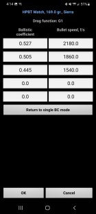

Does anyone have a BC table (BC vs vel) for the 169s rather than just the single (.527) value given by Sierra?

Most likely too slow. I pushed them at 2875 out of a 32" to get ~1400fps on target at 1000. 1300 is getting into the territory that shotmarker won't register
