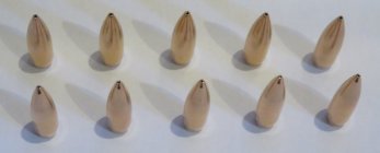

When I didn't get my order from Sierra, I saw the Midway some available but limited to 2 boxes of 100. So, I ordered the limit and just got them today and will be getting some loaded up to fire this weekend. I just finished measuring them to get an idea how I want to go about loading them. Here's some number's I came up with. . .
Bullet Length: 1.301
BTO: .650
Boat Tail: .168
Bearing Surface: .483
Compare that to my 168's . . .
Bullet Length: 1.214
BTO: .617
Boat Tail: .144
Bearing Surface: .453
The 169 SMK meplat is definitely smaller than the 168's (see pic: top row are 168's and bottom row are the 169's)

It may be hard to believe, but I've shot the Berger 168 Hybrid for years, and believe me, it IS waaaay better than the 168 SMK. The 168 Hybrid does not suffer the boattail angle issues that plague the 168 SMK past 700-800 yd. It's also one of the few .30 cal bullets I'm aware of that has a high enough BC that it can provide equal or better performance than the next higher weight class of bullets (175s-185s) due to the higher velocity attainable with the lighter bullet. Because of its relatively high BC for its weight, the 168 Hybrid can be pushed fast enough with the appropriate length barrel to overcome the BC deficit as compared to something like a 185 Juggernaut. That can be useful feature to individuals with rifle that are not throated long enough to load 185+ gr bullets optimally.
This new 169 SMK looks to be on par ballistically with the 168 Hybrid, and has a BC that is approximately 14% higher than the 168 SMK; a sizable increase. Of course, some fraction of that increase would be due to the fact that the 169s are pointed at the factory, whereas the 168 SMKs are not. The 169 SMK might even be more forgiving with regard to seating depth than the 168 Hybrid because of the tangent ogive. With the assumption that they can be loaded to equal precision as the 168 SMK, I can't imagine why anyone that shoots 168 SMKs wouldn't give them a try.
