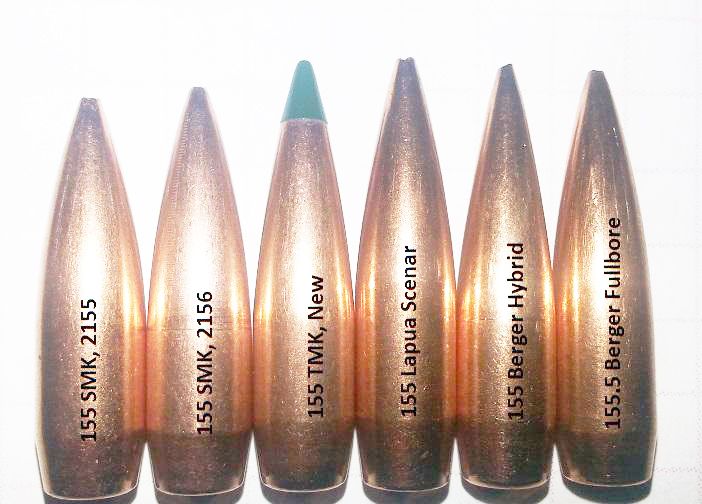

took some mug shots today. Quite the departure from the typical Sierra Line up in Bullet design. Found it quite interesting. If the gosh darn weather would break I could test em.

Great pic, OK Weber has them in stock, but only 500 packs. Was thinking of ordering to try some. Will wait until people like you take them for a test drive. Heard Bob Mead shot them at AZ. They definately have a different profile from anything Sierra has ever done. I hope they are not sensitive to seating depth like all the other Sierras, or Berger 155.5 for that matter. Glad we have competition and Berger/Sierra keep trying to improve.
Keep us posted on your findings.

Easier to see and read...

I'm curious to see what kinda results you guys get with the new Sierra bullets. Thats a very high BC for a 155. Hopefully they shoot well!
Looks like the TMK has more bearing surface then the 2156. I could not get the 2156's to shoot in a 300-308 barrel.
