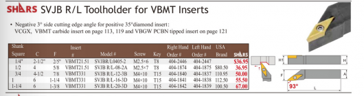

No room. But I think a left handed tool on the front of the tool post would work for this. That would get the cutting point right up behind the follower plate
Have you got enough room to run a boring bar upside down? You could get the cutter basically hard up against the plate and it would be throwing swarf down into the chip trap when running in reverse.
Or left hand turning holder using maybe an 80° insert...
That's what I did last night poking around. I can't move the cutter too close to the rest, or I wont be able to reach the muzzle end of the barrel, because the tool holder will bump into the tailstock. I think I have it where I can taper everything up to the last 3 inches of a barrel. That's just right, for me.

I think I have the toolholder you need. Stand by for NEWS.
Aaron back to your build. Looks like you have an aluminum air manifold of some type (back top of your plate). Where did you source that? Also, did you end up putting that valve in? I have most of what I need ordered. Now it looks like I'll be buying a toolholder lol. I like these projects especially with winter in WI approaching. thanks

@DaveTooley That's super kind and awesome of you, but I already cut a left hand holder up for the task.
If I get bored I might make a custom tool post to hold it
I've been wanting a set of those. I have a bunch of DCMT holders and inserts. One of my favorites to use.
