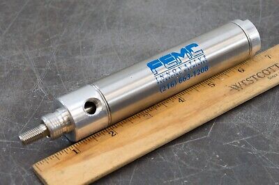

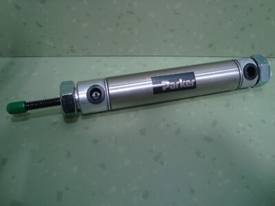

Check the other thread about profiling barrels. xr650rider gave out the parts list. Smaller actuators would be handy. I found these 3 on ebay from someone local
