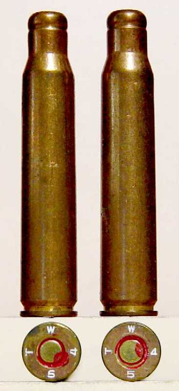

This is baloney. You cannot tell an 8x57 case formed from a .30-06 blank because the neck gets cut off. All you can tell is that it was a .30-06 case. Here is proof.
