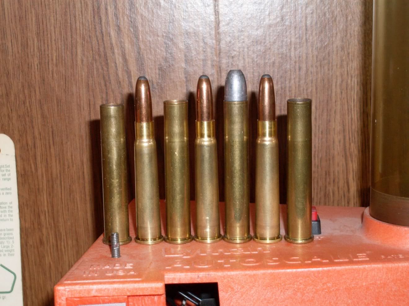

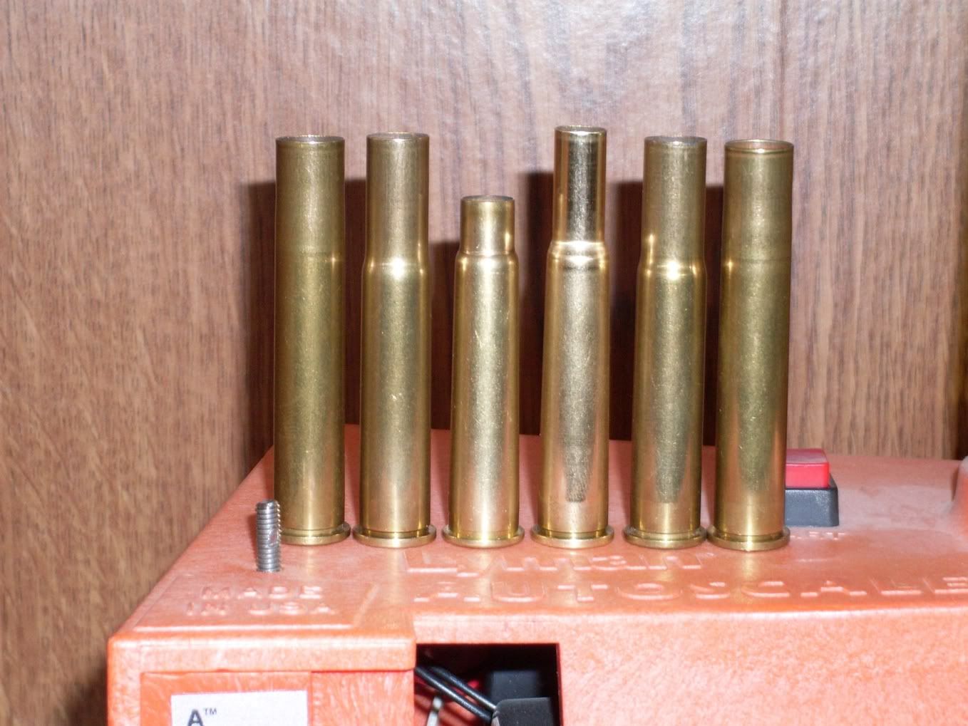

Did you ever shoot a real bench rest rifle?
Another question. I guess you find it impossible to form .303 Brit cases out of .405 Win brass using all conventional dies? I have no trouble doing it.
And according your statements apparently you cannot make 6.5X53R Dutch Mannlicher out of .303 British because you cannot figure out a way to change the location of case shoulders.
Can you even post photos?
