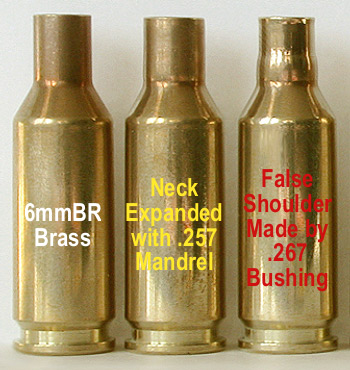

With new excessively short cases I jam the bullet into the rifling with a mid-range load. This holds the base of the case against the bolt face when the cartridge is fired. Another method is creating a false shoulder by expanding the case neck and then reduce part of the neck back down to hold the bullet. This is a lot more work and the false shoulder needs to be adjusted to allow the bolt to close with firm pressure. Meaning the false shoulder is holding the case against the bolt face.
Below example of false shoulders, the "fat" section of the neck holds the case against the bolt face and prevents the case from stretching.
