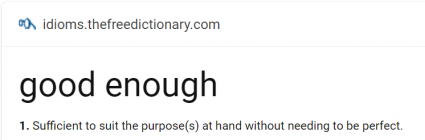

I'm glad you view it that way, but I don't believe it.
"Good Enough" is something less than perfect, sufficient.
You mow your grass into a perfect checkboard pattern, every week? You measure all of the resulting squares or diamonds to make sure they're all equal? Never skip the weeding/trimming? Clean your car to perfection every time?
Everyone decides that something is good enough, no one has time to make everything perfect.
