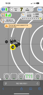

One very odd error we found at the last match was a shooter's rounds were ending up two minutes to the left (see image). This person is a very good and season shooter with a properly zeroed gun. What could possibly cause that?
The other observation I have is these "The xx sensor appears to be disconnected" seems to always be the top sensors. Having seen so many of these, I find it extremely odd that they never seem to be the bottom sensors.... This seems to also suggest it is not the plug/cables as if they have problems, the problems should be more random?
