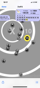

is there a setting you have to set to allow this? So far, each time I've seen someone change the caliber, it did it for all targets currently linked. Curious if there's a way to do it without changing others.
This is my experience as well at our range. All of the targets stay paired to each other. You have every guy changing their caliber so no telling which caliber we end up on for each relay.

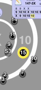

It can make a difference from time to time. Yesterday at 600, a TR shooter hadn’t changed our default 7mm in the first match.
Once it was corrected to .308, shot 7 became a “10” on ShotMarker instead of a 9 with a .284 setting.
I originally thought that all targets were changed to the same caliber. This thread got me investigating. After fiddling around a bit I discovered that you CAN have different targets with different calibers.
The access point menu sets the default caliber (or "global" setting), but if you go to the target face menu [LR (800-1000), MR-1 (600), etc.] on the top right you can change the caliber for that specific target. Setting security mode to low will remove everyone's access to change the default caliber settings, but leave them able to change the caliber for the target face. If you modify the default caliber on a face, it'll remain even if you change the default setting.
Not sure if this makes sense or helps, but thought I'd share with everyone.
*Edit to add: Once you save a target with a caliber that was modified from the default/global, the target resets the the default caliber for the next shooter. Just tried this in "shot simulator" mode.

Well, I was wrong in my thought that all targets had to be same caliber (see above post), so I could be wrong again, but I think changing the grid (off, 1 moa, 0.2 mil, 1 inch), velocity (off, fps, m/s), stats (off, score, inch, mm, moa, mil), shots (all, recent, delayed, restricted, disabled), sighters (none, one, two, two convertible, unlimited) and target row (hide, show, show & highlight) ultimately changes it for all targets at the same time. Caliber has been the only one I've found a way to be able to change for each separate target.
If others have seen ways to make independent changes on these settings, I'd love to hear the instructions.
Yes, and that is where the problem lies. I found most shooters, even some who own shotmarkers, do not understand that there are two ways to change calibers. The Administrative needs to have security set or there can be problems and not just with caliber.
Global settings effect all targets. You can change individual target faces and caliber in the target setting for the target selected in the target row at the bottom. The target setting looks like a target at the top left row of icons.

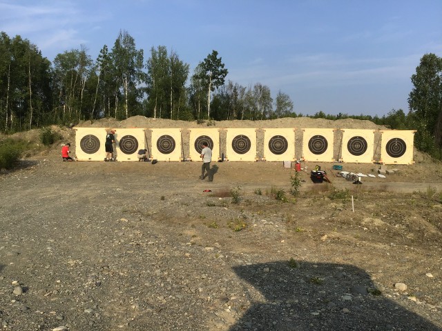

This weekend at Mill Creek Rifle Club, we ran a Midrange on Saturday and XTC on Sunday. It suddenly dawned on me, that we are gonna have a new generation of shooters that have never pulled pits.
Our entries are slowly increasing. "If you build it they'll come".
I have never liked carrying targets around. At my local club, the targets have been housed below ground at pit level, but are shot at ground level. We shoot year round, and the pits are prone to flooding, to mud, and the housing to wasps and target damage. Even in perfect weather, it’s a hike up stairs and maybe 150 feet to the furthest “stand”. I set up and take down, which is the safest most appreciated way for a match director to do it, but it was requiring a longish drive the day before, to ensure a smooth morning match. So, enough of that, I bought and modified this small trailer.
We were early converts to etargets, and the 4”x4” sunken post system at the base of the berm that massive targets (1539 mm microphone spacing, square, much bigger than these) were clamped to, have long-since started tilting, bending and generally been shot up in the other 30 days of the month, over the last 4 or 5 years. Foliage on the ground was a constant issue.
The targets above are easily big enough to capture all shots. Midrange target rings are simply bigger than we need in FClass and that’s all we attract. We have never struck a sensor hub, suspended above them.
So, crosstalk has been the concern with these, since the beginning. But fortunately I’m not seeing any, in early testing yesterday. For most matches, 2 or 3 targets is all we need.
The idea here is to modify a utility trailer which will become both a stable base to affix the targets to, and the transportation and storage of the targets, back to a garage, where they will not be eaten or grow mildew. The total distance any target moves is 4 feet and set up is as fast as it looks.
That run of flat steel is 1” thick, about 3” tall, and perfect to C clamp the frames to.
Obviously, you don’t want your trailer shot up as if it’s just the rail holding up targets in a silhouette match, But I don’t think that will happen. I’ll put a test gong nearby.
