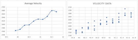

Here were the results (I will spare the individual velocities, just the important numbers). Any thoughts or suggestions to check that I may have overlooked or haven't considered?
For clarification these readings were taken at an indoor range shooting into the backstop and not a target so I don't have grouping results.
Charge - Avg(fps) - SD
39.9 - 2565.2 - 9
40.1 - 2572.2 - 15
40.3 - 2595.4 - 15
40.5 - 2598.2 - 22
40.7 - 2619.0 - 11
40.9 - 2630.8 - 15
41.1 - 2629.6 - 10
41.3 - 2646.8 - 23
41.5 - 2679.6 - 18
41.7 - 2673.0 - 12

Makes sense. I have no problem with that if that is the case. I want to get the best results with the equipment I have, thats all.
you may have to try a variety of bullets, powder combos but it will be a valuable learning experience, but the key is to have fun and learn and your at a great place to learn from the best shooters they are here..Try some Eric Cortina Vids
There are no awards for chronograph results, but a firing on the brass and a cci 450 will narrow this down.
Shoot several actual targets with a magnum primer in the 41 grain range, give or take some, using once fired brass. I think it’ll make a world of difference for you.
I am not impressed with velocity SD so much as I am with group size. I would recommend focusing on group size first which means also working on bench rest technique, wind reading, etc. Pay attention to velocity while you are doing this but when you think you have the best group defined focus on velocity to see if you can improve on the group. The group size wins matches not velocity.
Now i just need to find some magnum primers, lol. appreciate the suggestion! What different would magnum primers make?
