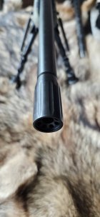

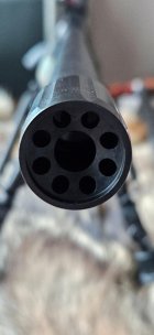

Thanks for the information. Your profile picture of the crown / muzzle blast, whomever did the crown did an outstanding job on it!
