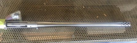

I have a project on a short magnum Remington 700.
Case is an Ultra Mag cut off about at shoulder. 50 Alaskan reamer run in till the rim touched then a reamer I made to square the end to headspace on mouth.
Metal is done. Stock getting there.
Will take pictures.
photos
19” barrel, blended brake. Chrome Moly, will be blued, Parkerized, Cerekote. Something.
Dummy round next to a 308 Winchester. Bullet is for an Alaskan so it’s short in front of cannelure.
No pic, stock is a McMillan HTG.
I think it’s 75 grains of ball powder to base of bullet.
Going to start with the fastest powder loads for the 50 Alaskan and work up stopping when still fun.
