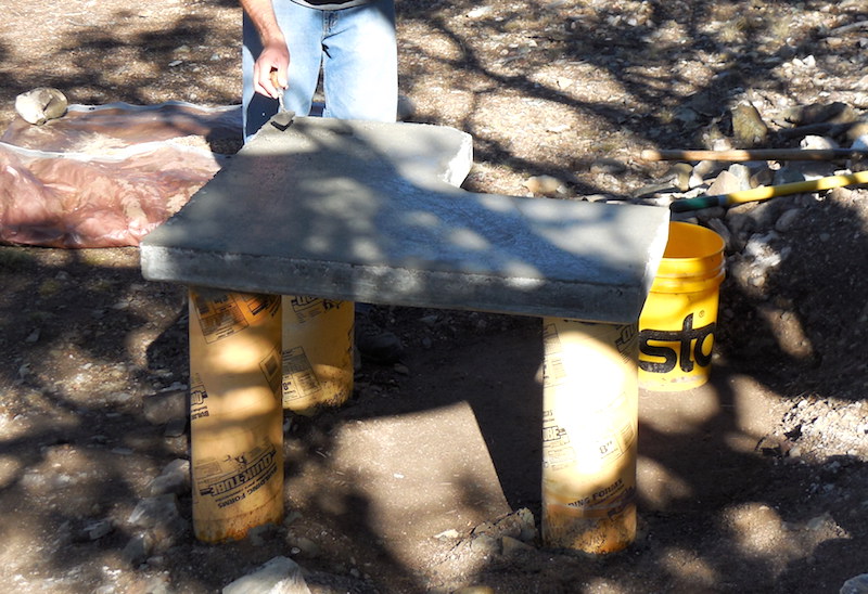

I would consider molding a top from CSA concrete. It's lighter weight and stronger than Portland cement and is impervious to weather. But it that idea leaves you cold, maybe this will give you inspiration.

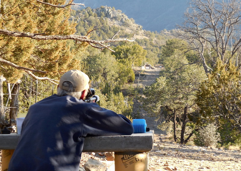

Looks kinda short, (low)
20cm OD Sonotubes make it look squat, they are buried some, earth mounded around them for additional support as they were cast separate from the top. The camera's perspective has an effect, I'm in the photo and I'm also 195cm tall. FWIW, the chair's adjustable height too (not pictured).
Shooter's 175cm tall:
