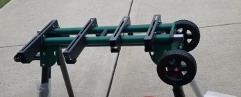

I drilled down through and bolted them on with carriage bolts.
Bad wording on my part. The legs proper are long and relatively slender, I'm interested in the parts with bolt holes, between the legs and the top, sometimes called "stanchion" or anchor fitting. A picture is worth a thousand words.
