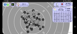

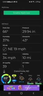

I worked up a load for my newly acquired 6BR using SW Match Rifle. Bench shooting had the load right around 1/2 MOA. This last week I decided to mount a set of irons and shoot the 300m course of fire with it. For those unfamiliar, the course of fire is 60 shots plus unlimited sighters in a single 70 minute block on the NRA C-3 target (10 ring measures 3.6"). I'm very happy with how the rifle and load performed. Under better conditions with better lighting and less wind I'm confident the score would have been better.
