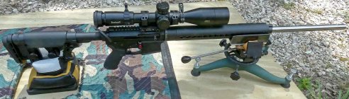

Bought a Shadetree top to go on a $99 (on sale) Caldwell rest/bag from Midway for the wife's AR
(22 Nosgar). Made a bag rider with a little weight (2.5 pounds). I'm a 'why buy if you can make it' guy.
11.5 pounds @ the front rest, 7.4 at the rear bag.
Should get to the range next week for her to practice. She's made it to Midrange Expert and wants to Master this summer. Flo-Rest.jpg
