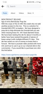

Thought someone would like to see this, i have ordered one to test for myself. I quit messing with my 6mm arc due to this problem with Hornady loaded ammo. I now have starline brass and will see how this works. Screenshot_20231027_112356_Facebook.jpg
