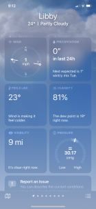

I bought a cheap weather station on Amazon. Keeps track of Temperature and humidity and other things if I want to use the attachments - wind speed and direction etc.
I have a couple of these. One at home and one in the camper for matches. They are both within a couple points of a much more expensive weather meter I have.
I guess if you believe 2 or 3% difference makes or breaks your tuning you should maybe purchase a better unit.
