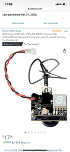

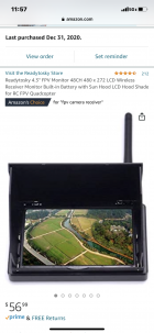

bottom line, if there is mirage, nothing works at 500+ yards or more. so i ended up build a remote viewing system out of FPV parts.

Build a target camera. I built mine for less than $100.
Target camera, at any distance the signal transfer will allow, no matter what mirage. Or, for 1000yd, white painted steel and a high magnification scope and watch the dark spots (bullet splatter).
