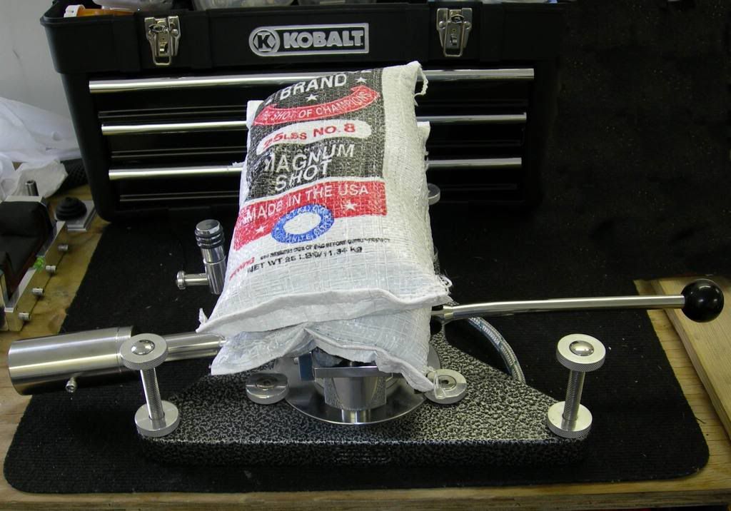

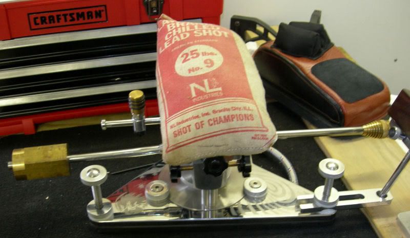

Yes, a counterweight can be retrofitted to your current rest. It's just a piece of metal/weight, attached to the center shaft (#13 in the exploded drawing).
But remember, the counterweight is/will only work if you use the rest in "up for up" mode.
If you use the rest in up for down mode, the weight must be placed on the handle/joystick side.
(If you notice, the joystick can be attached on either sides of the center shaft, therefore you can either use the rest in 'up for up' or 'up for down' mode).
A little story about the counterweight:
Paul Schmid (R.I.P.) & I invented the counterweight in 2008 when/after a customer asked a rest for his Heavy Gun. (We called it "balance weight system" or SEB "BWS" at that time). The function is, to balance the mechanism, for a specific gun weight on the rest top. We did some extensive experiments at that time and found that our old SEB rests could accept 60 lbs or more weight by using a counterweight and still maintain smooth action. We also found that, the old SEB rest can have a smoother action using a counterweight.
I'll try to attach a photo here....
Then in 2010, when I was designing a new rest (the NEO) and asking inputs/opinions on what people do not like with my old SEB rest, I found an 'alternative' to the counterweight, i.e. the internal built in uplift, which utilize a pair of leaf springs in the inside.
Personally I prefer the built in uplift (since it's 'more simple' & I don't have to bring/put more weight on the rest when shooting overseas & the fact that the action is quite smooth already), but Mike Ratigan & several others prefer a counterweight & remove the built in uplift / leaf springs inside. Yes, the rest works smoother/finer with a counterweight, also gives more uniform tension/force in all planes.
Both methods has their own +/- . If total weight is no concern for you, the use of counterweight is better/smoother.
We make various weights, for LV-HV gun 10.5-13.5 lbs, for LG/F-Class gun 16-22 lbs, etc.

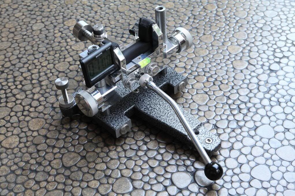

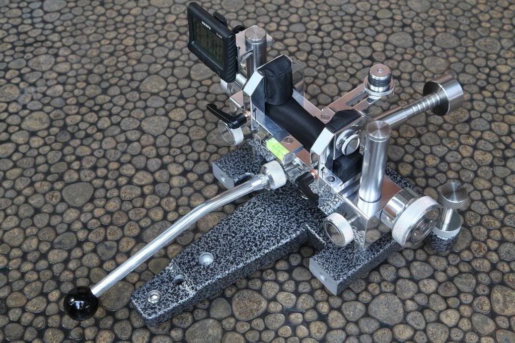

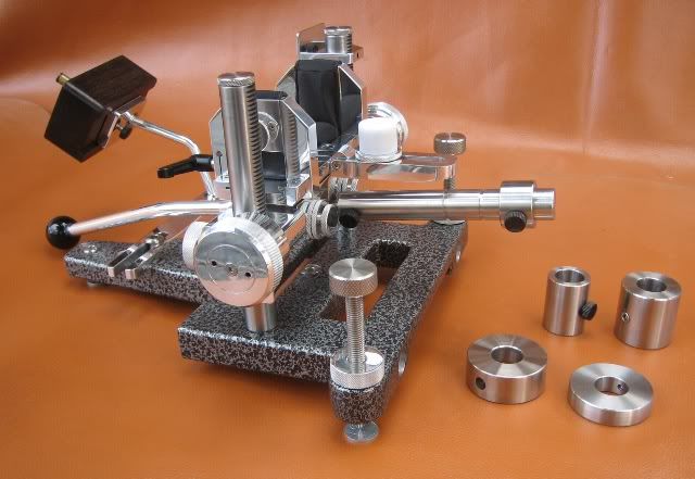

Update, August 21.
I made several changes to the NEO rest.
The new/improved rests have adjustable lever screws on the top/side plates assy, larger thumb nut on the joystick head, improved built-in uplift & clutch brake mechanism. These changes make the new rests even better than ever.
You can call the new rest as "NEO Mk.II" or "NEO gen 2" or "NEO 2".
The CTC between the bearings is also shortened a bit, for more finer adjustment on the target & a smoother action in the same time. Yes, the MOA/travel will be somewhat reduced by a bit.
I will attach some photos here...
I charge $ 60.00 for the improvements. Timer holder is optional. Contact your dealer for new pricing.
If you have any questions about the new NEO feel free to ask / email me.
We will also have our website updated soon.
Thanks you for your attention,
seb.

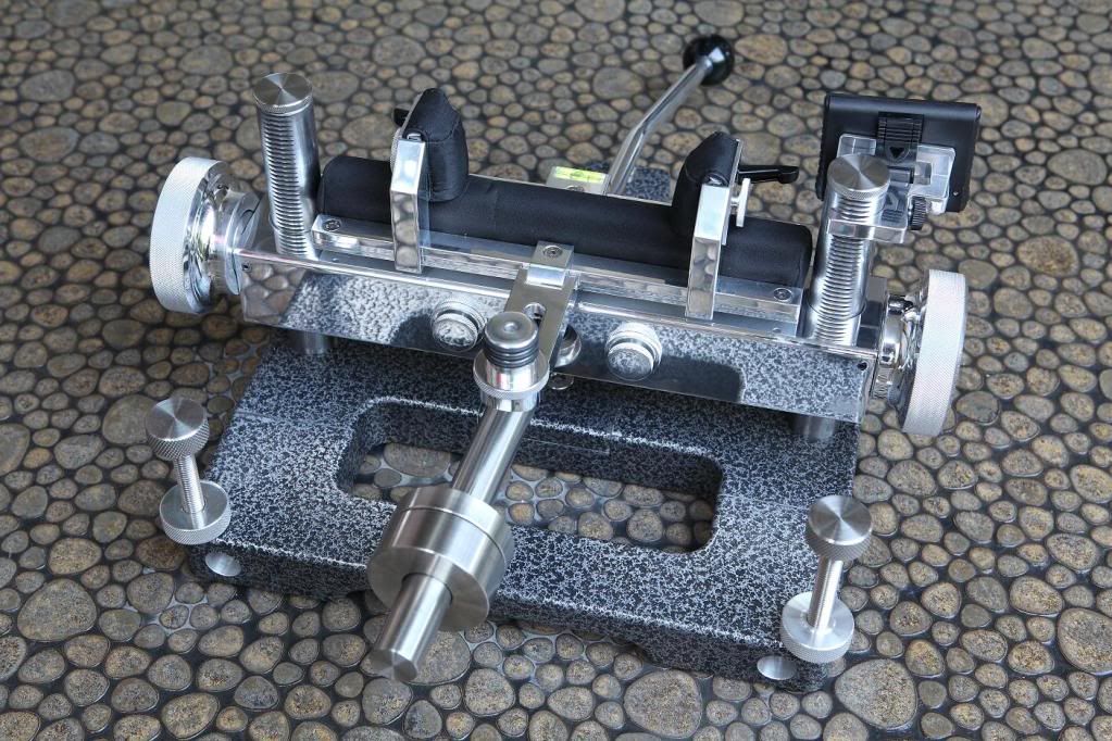

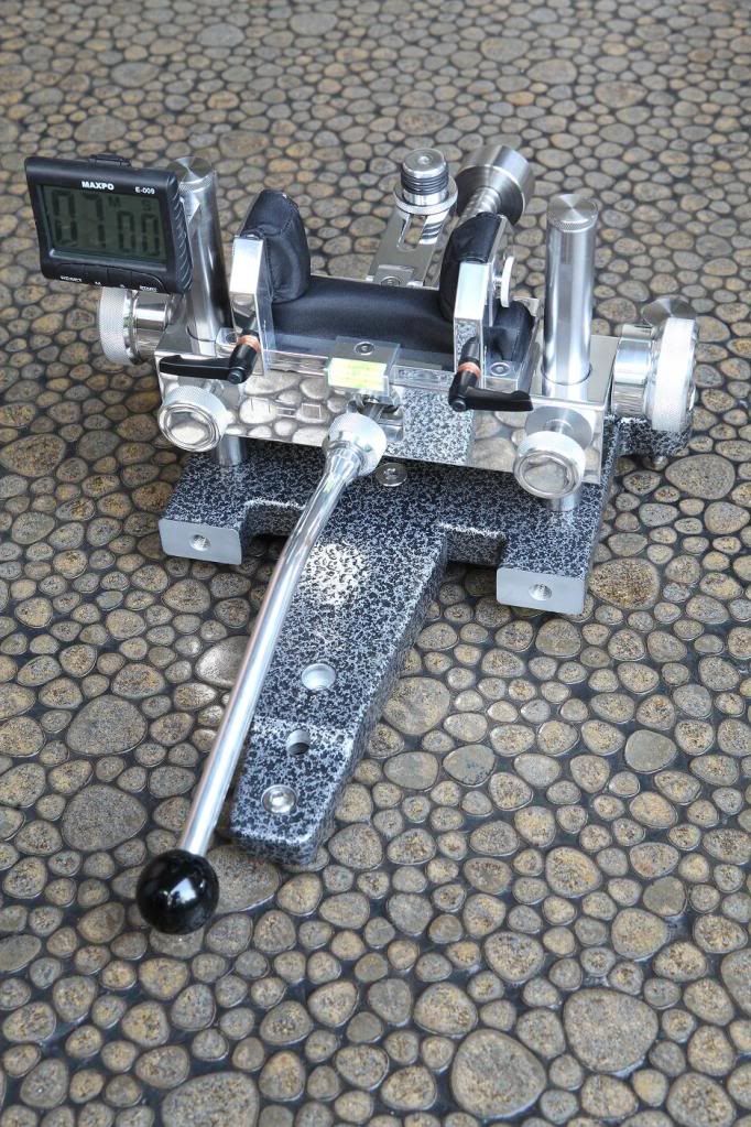

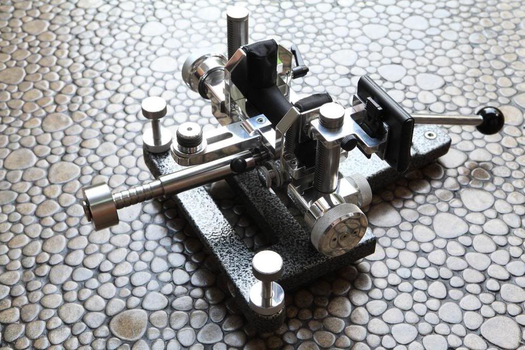

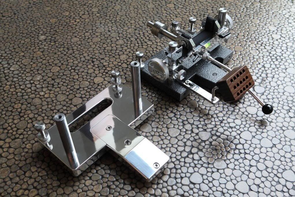

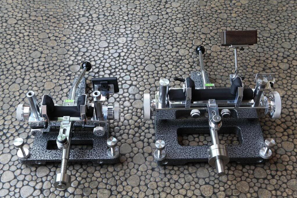

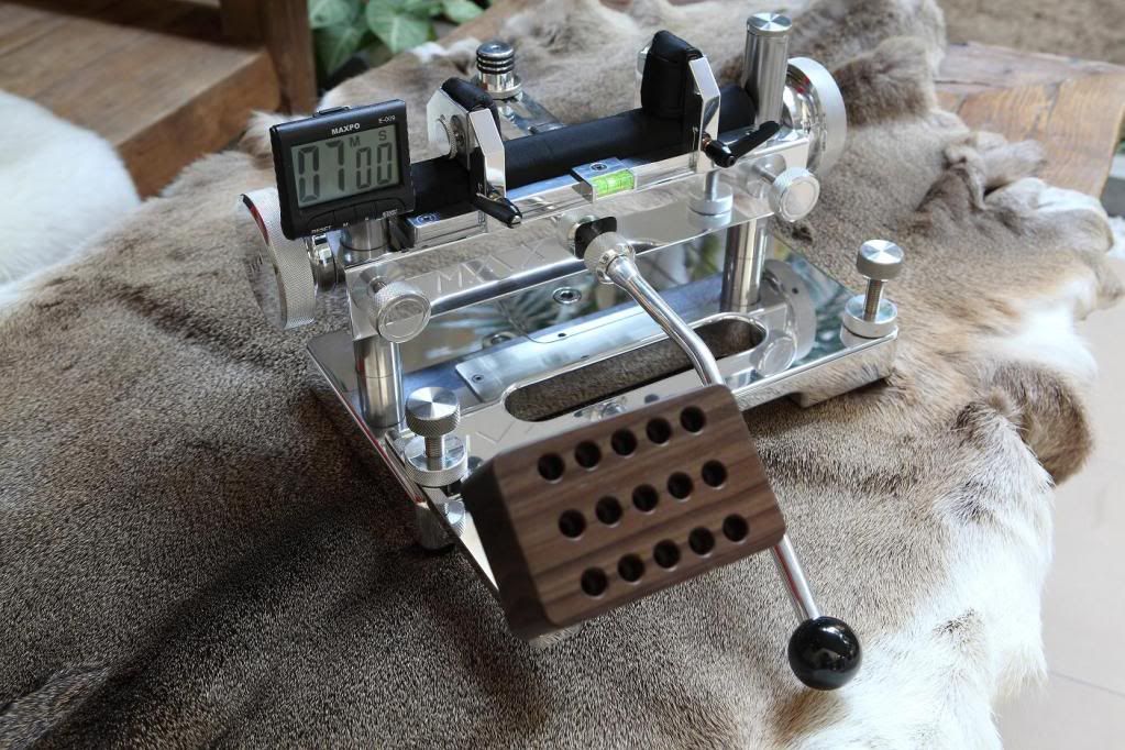

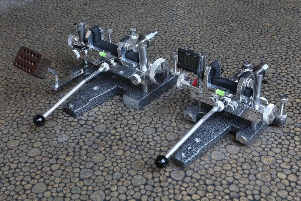

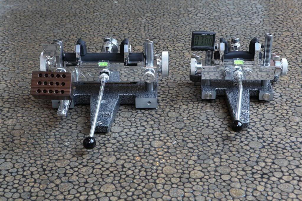

More photos.... NEO & MAX side to side.
Re: the MAX.
First run of the MAX (75 units) to be released around late Nov - mid December 2012.
I have 63 units spoken for already. (Thanks you gentlemen for your confidence in my product! also for your patience!)

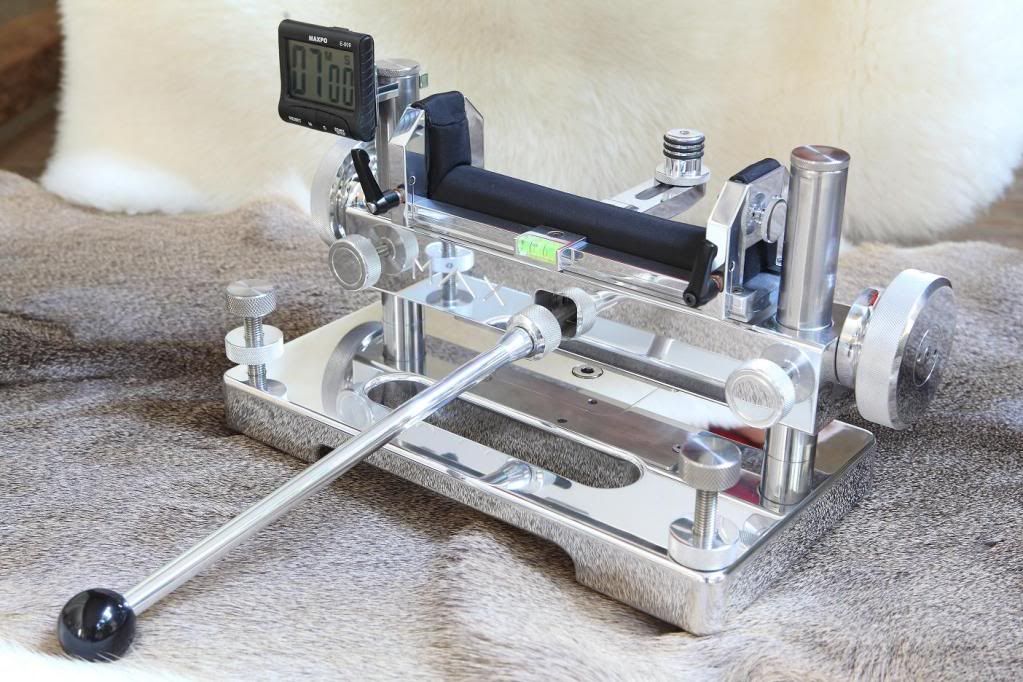

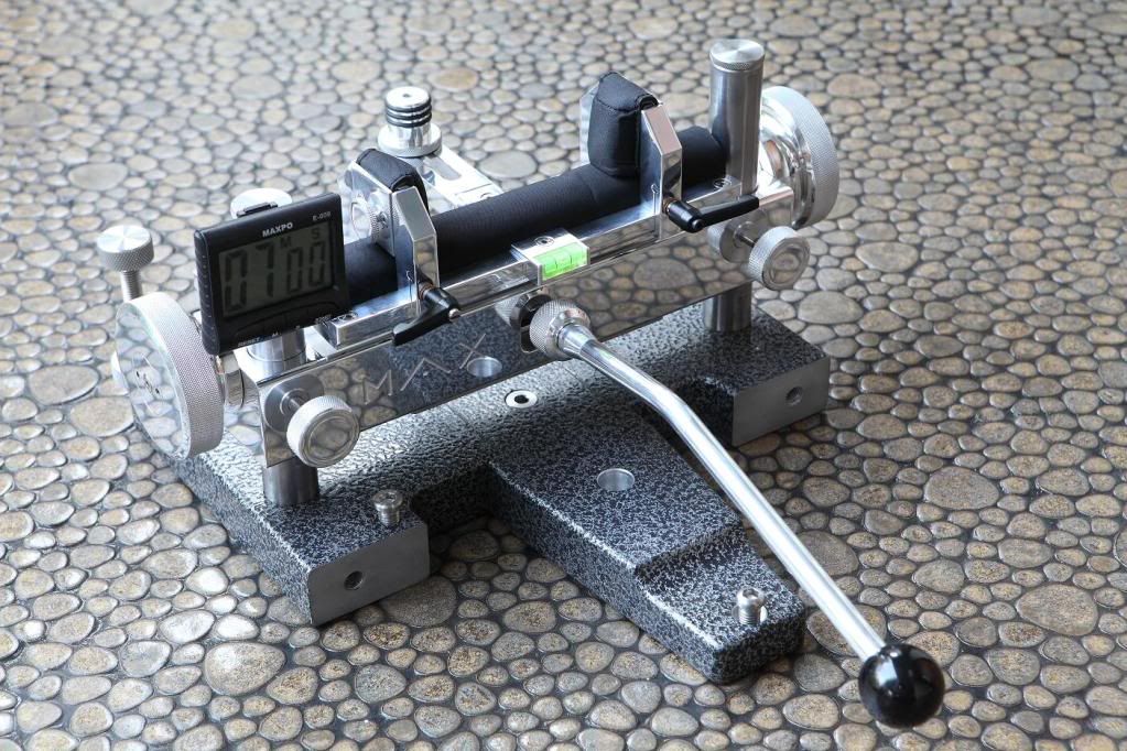

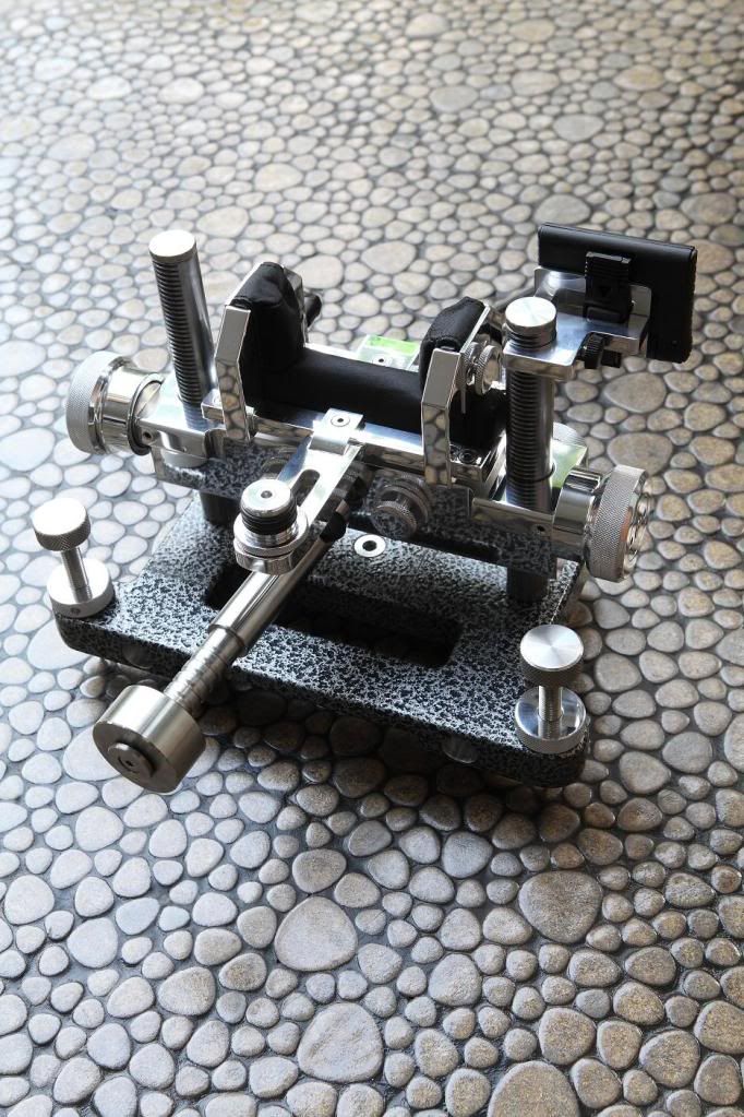

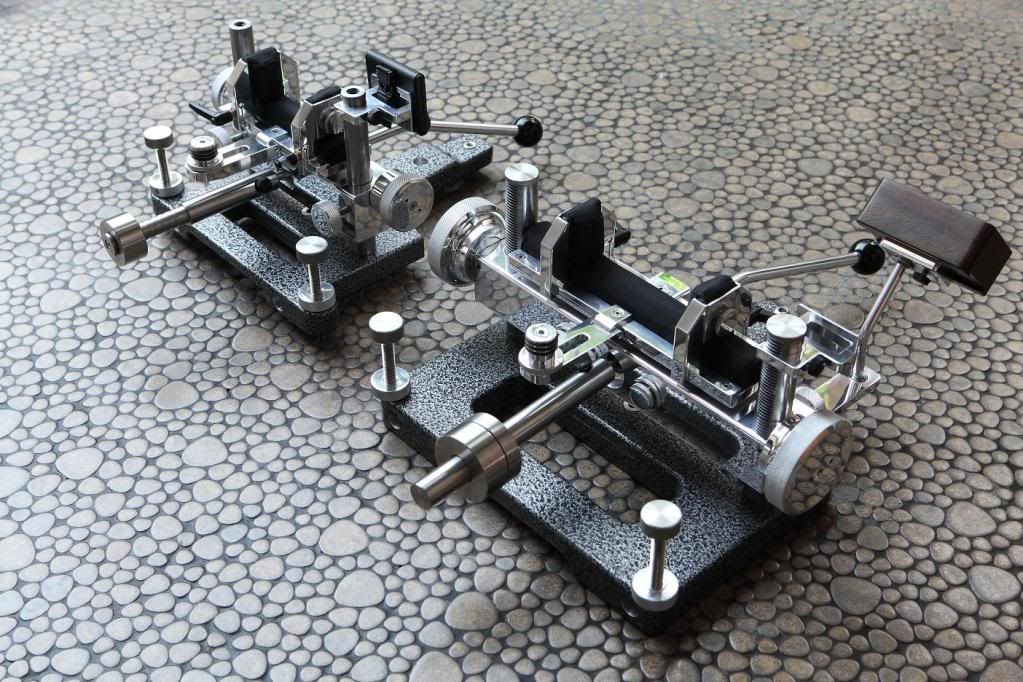

Here some photos of the Regular MAX & the Special Edition.
It's the latest model. (I will donate it / the regular model to the IBS 1,000yds National in WV & will make sure that the rest arrived before the match).
With the standard 3 pc bags (adjustable from 'zero' up to 8" wide). The bottom bag is thicker now.
With 1 pc bag 8" wide. (yes, the bag protudes more than 1/2" over the metal/leveler/stopper if you wonder about it)
Anyway, I might (still) probably change the base design...
The current regular model has 3 pc base & can be set with the single leg in the front or at shooter's side (it resembles the NEO's configuration).
The special edition has 2pc base & set with the long leg in the front. It's also will be used in up for up mode in this configuration.

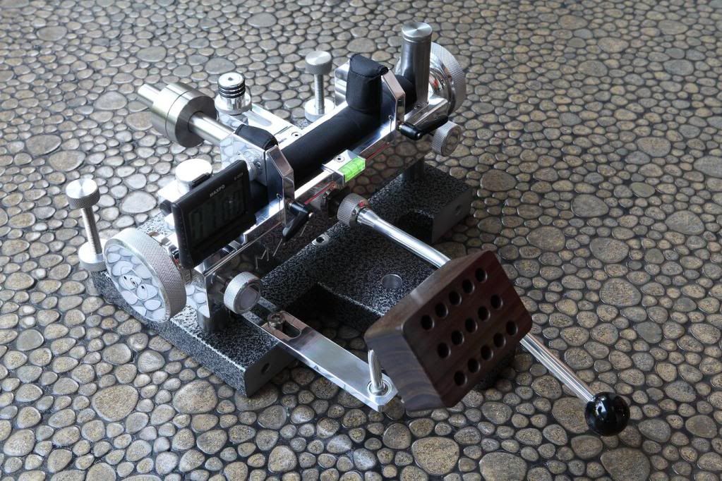

Any inputs/suggestions will be much appreciated.
Both models weight about 44 lbs, excluded the counterweight.
Yes, it is built like a tank!
Ammo holder set & timer holder are optional.
Standard counterweight (adjustable) will be included, to accept/covers 40-60 lbs gun.
If you need more weight please let me know.
The MAX can accept gun up to 90 lbs, maybe more. Confirmed. The good thing is, joystick operation is similar to a NEO for LV/HV to LG gun use. (the 'key' is the counterweight. It must be in correct weight/combination).
