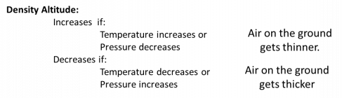

Yes it is a combination of most all the atmospheric conditions that play a role in controlling tune. I've been told it is summed up with density altitude.
Air density plays a role but smokeless powder turning from a solid to a gas is a chemical reaction. Im not aware of any chemical reactions on earth that are not temperature dependent, to varying degrees, of course.
That said, if you shoot in an area where temps stay stable but density changes more dramatically, relatively speaking..that's when you'll see density be of larger relative importance. Bryan Z did his testing in just such an area, the pacific nw. Most of the country will see bigger affects from temps but temp and air density are also related but not linearly all the time
Hence, there are times when the same temp swing that held tune all day today, goes away tomorrow. An extreme example would be a stable temp in a super low pressure storm front, but good winds.

I dont know what parameter plays the bigger role but I have worked up a load in 50F weather and had it shoot like crap when it suddenly warms up a week later to 70F
This is true but while density goes down with temp increase, its not necessarily the same air density over the same temp increase, from day to day etc. Non linear density change over the same temp swing.
Same, tuner or no tuner. These are the challenges to KEEPING up with peak tune.
