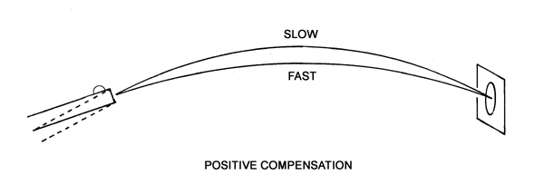

If bullets leave the muzzle axis on its upswing at the right place, slower ones will leave at a higher angle from the LOS compensating for their greater drop at target range.
Weights on the muzzle adjust back and forth to "tune" the muzzle axis ertical vibration frequency to make that happen. Groups at half range will have greater angular spreads so the tuner can be adjusted for best drop compensation at that range.
Please explain, "Groups at half range will have greater angular spreads so the tuner can be adjusted for best drop compensation at that range".
I think hes saying that half way to the convergence point (target) will be the largest divergence /the highest point has the largest gap between fast and slow.
Adjusting the tuner can move harmonics so that the convergence point is where you want it to be instead of just the distance it was previously set up for.
I think hes saying that half way to the convergence point (target) will be the largest divergence /the highest point has the largest gap between fast and slow. Thanks, I understand positive compensation, it was just not clear that was what Bart B. was referring too. All is well.
