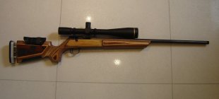

Here's my CZ 457 mounted with the Leupold 45x45 Competition scope.
It's great. Shoots well.
But am I worrying too much about the amount of scope hanging out the front unsupported by the front ring.
The scope is where I need it for eye relief. The mounts are where they have to go.
But the large (to me) amount of unsupported scope tube hanging out from that front ring to the objective has me worried about bending it, or maybe it might affect accuracy (?)
Do I need to fit a rail? I like that the current setup has the scope objective down low (about 1/4" clearance to the rifle barrel).
Just looking at rails and at most I get another 1" of support (by allowing the front mount to move forward).
Is that extra 1" of support worth the hassle?

I found these (seems like quite a few folks make them). It just extends the front mount.
https://www.opticswarehouse.co.uk/b...iece-double-strap-offset-dovetail-scope-rings
That might work too.
This rifle is never going outdoors!
No woodchucks, squirrels, or prairie dogs will be hurt.
Strictly indoors range only, and carried in a nice stout case..which I have yet to build (wooden case as per my Martini) or buy (plastic with lumpy foam packing).
So, as this rifle will be pampered maybe there will never be an issue.
I'm just making sure, and every little bit helps.
BKL makes a cantilevered mount that fits an 11mm rail. Rear: straight, front: cantilevered. Could provide the additional support you are looking for
don't over tighten it to compensate, rings have left marks on the front already, you have to relieve the rings at the split or they will dig in when you torque them down, original question I think your good, I wouldn't worry to much, Unertls use to stick way over
Be sure when in a hard case to keep the scope on top when carrying. If it happens to drop, you don't want the weight of the rifle going down on the scope which will be held firmly due to the big objective. All that over hang provides a lot of leverage.
