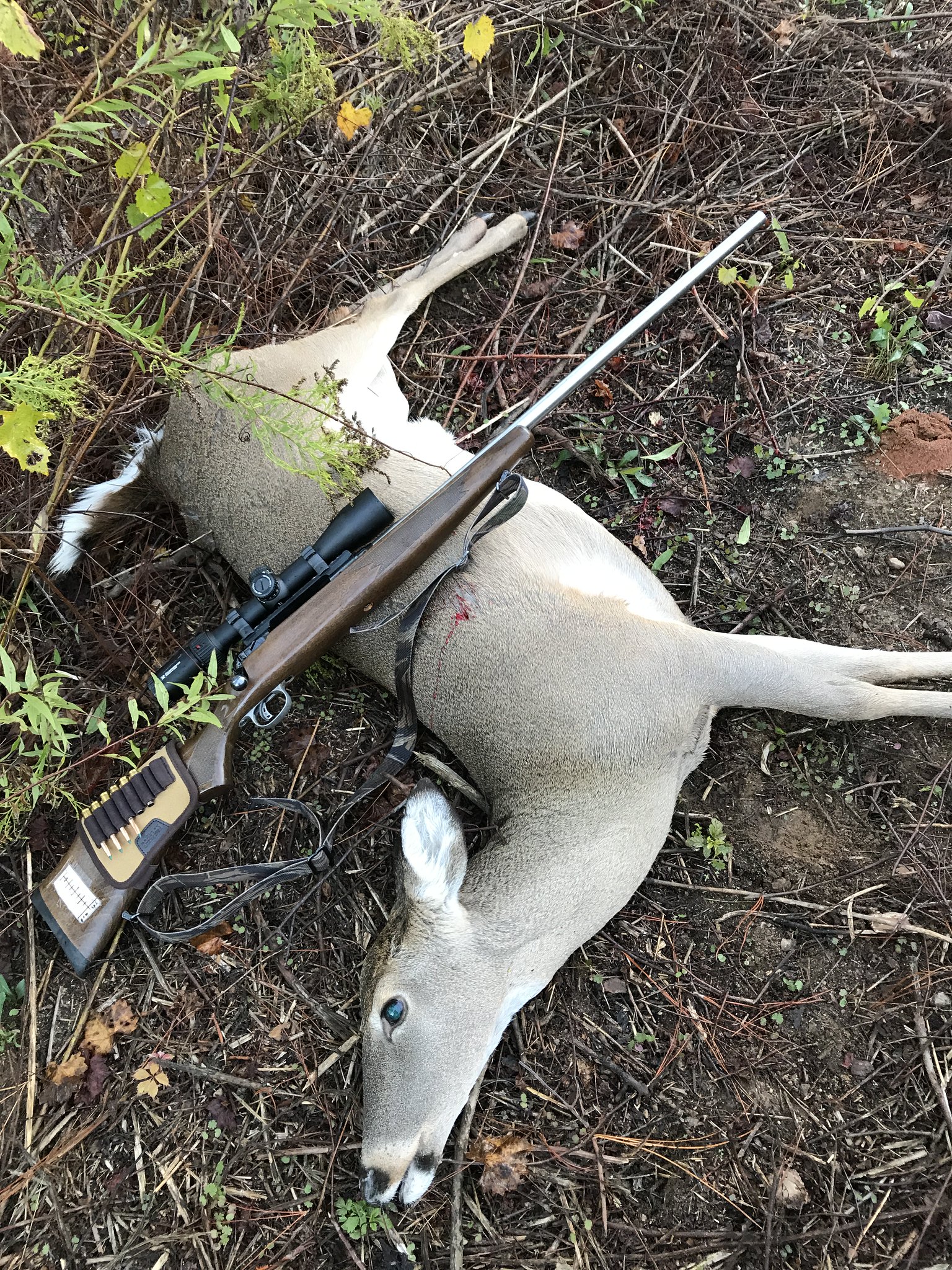

D21F0453-900B-428F-B538-186F4745F445 by Larry Malinoski, on Flickr
Look closely at the picture. That is the scope and the rifle. See the little tag pasted on the buttstock - upside down so you can read it from above? Look, pick any power you want, find the correct mark and shoot. No fussing around with scope adjustments, setting correct power for hold-over...just shoot.
FFP is an option for hunting, not target. With hunting the target moves around, unlike paper or steel shooting. No time to fuss around. The "old fashioned" Front Focal Plane has a place when hunting for many informed hunters.
***For those looking to criticize because of the two empty cases in the buttstock carrier, I had killed another deer with one shot just before this longer range one. Two cases - two dead deer. Georgia - I killed three does and a 9 pt. with rifle and one muzzleloader this past season but you are allowed 10 does and 2 bucks.
