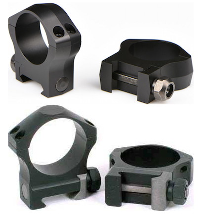

I don't see any issue with the aluminum Mountain Techs. It's a very similar design to the Nightforce Ultralights, just heavier. I've been using a set since 2018 without issue on a NF ATACR, but it's a heavy gun w/o much use or recoil:

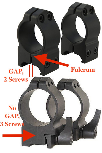

The Non-QD Warne Maxima design is a balancing act between the 2 bottom screws that clamp the rings to the base and the top 2 screws that hold the scope tube. If the scope or the mount (or the receiver e.g. Rem 700) are out-of-spec/crooked then the "proper" screw torque can leave one side of the "fulcrum" looser than the other. It's quite possible to be the victim of production tolerances.
The Warne Quick Detach design does not require the same balance of forces to work. There's a flat where 2 screws clamp both ring halves together (similar to the Talley steel vertically-split design) and one additional screw securing the scope/ring assembly to the mount. The two screws at the top clamp the scope tube and are, for the most part, independent of the other three. In my opinion, the design's more tolerant of variation in mount and scope tube tolerances. It's still a PITA to mount scopes precisely with the reticle level though.
