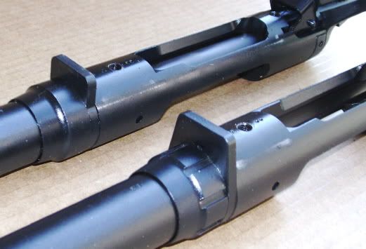

They are not the same. I know the recoil lug on the Axis does not fit around the barrel, like a washer on a bolt would. It is more like a key that fits in a key way that is machined into the front of the action on the Axis. Hopefully this helps. The Axis is on the top.

I had a axis apart last night. I was looking at the face of the receiver and i has no threads and a relief all the way around the thickness of the keyed in lug. I wonder if i could put it on a truing jig and face off that relief on the front of the receiver and then just put on a standard lug and bed the stock? Just a thought not trying to hijack. Matt

They do have the axis with the accu trig. The accu trig can be fitted to an axis , even the target version . The recoil lug can be fitted if you want , the action needs to be cut back , but this can be done easily while truing .

I have a Savage 110 in 6.5x284 which was originally a predator hunter model. It has the same recoil lug you show on the axis as well as the same round lock nut on the barrel. I like the Savage other than the stupid bolt release on the newer ones like mine that is in front of the trigger guard. That mechanism also makes the trigger unique. Mine is no longer stock, has a Choate varmint stock and a modified accutrigger. Shoots well however.
I could be wrong but I believe that the picture is of a couple of 110 actions. The top appears to be a round back for an Accustock and the other has a old standard recoil lug. Again could be wrong.
I too have an Axis, was a 223 but now its a 223 Imp and a 20 Practical, both shoot better than the original barrel. Plus I stiffened the forend of the stock and stuffed the butt with sand, which with the heavier barrels, the gun balances just about midway of the mag. I replaced the too heavy for target shooting trigger with a Timney. Also tricked out my Harris bipod for a more stable stance. My Axis has the key way machined in the action and the recoil lug embedded in the stock. Also, the bolt is questionable as far as being different. I hadn't thought of truing the action and elminating recoil lug keyway but if I can find a single shot follower I might have to re-evaluate upgrading this toy....
