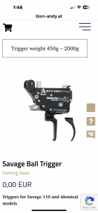

We will see how this rumored Bix & Andy Savage Trigger turns out, and if it can be sold at a cost that can justify hanging it on a Savage action.
After many years of trying, I ditched the Savage so I could finally shoot real triggers. I still have one Savage that I have not sold with hopes that someone will come out with a real benchrest trigger.
The B&A looks like it will be about 16 ounce pull.....hard pass for me.
According to the inquiry email response I received I wouldn’t necessarily consider these triggers rumored. However, price point will definitely be a consideration.
