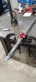

Removed a Savage Smooth Round Barrel Nut on a 6/5/284 Savage, Got a Smooth Barrel nut wrench from 4 D Reamer , Took 2 Gorillas & a 900 LB MotherFer to Remove,about 90-100 lbs tourque & it was Glued to ,Removing the Regular notched barrel nut one was easy with the Savage wrench from NSS
Contact James at Northland Shooting Supply (NSS) - he is knowledgeable and helpful . He recommended the NSS action wrench rather than a barrel vise. I ordered the action wrench, a Savage barrel nut wrench, a new barrel, barrel nut, and recoil lug from NSS for my Savage 12 barrel replacement. Follow the instructions provided by NSS. They also have Go and No Go gauges. Use 1/4” and 1/2” torque wrenches was to ensure proper bolt tightness. Rather than using a “cheater” on the barrel nut wrench, I found it easier to use a rubber mallet to lightly hit the end of the wrench a few times. The barrel nut breaks loose nicely without undue stress to the wrench or the action.

Some make things harder than they have to be.
Action wrench (NSS or Midway) nut wrench, place on the floor and step on the nut wrench. Done.
Screwing on the new one take your time and use a go gauge and then a piece of tape on the end (no go), try it a couple of times if you are happy with it go shoot.
