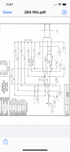

Can someone tell me the free bore on this reamer print?
I ordered my last reamer at 0.320 for no turn with Peterson and the new Lapua. It seems perfect. I wouldn't go any smaller and 0.317 is too tight for sure. I would guess a freebore of 0.185 to 0.215 would be a good range. I shoot 175 eldx in a 0.235 freebore and that seems ideal.
