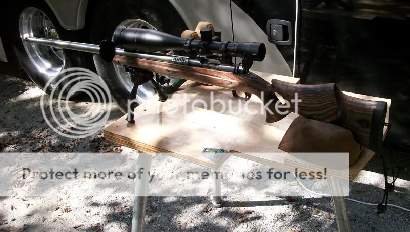

WOW, Erik. Your own personal 1000 yard range. That's fantastic. I've set up my steel as far as 1250 yards in Ohio (on farmer's property where I shoot groundhogs). The farmers don't mind as long as I'm also shooting groundhogs. I do all my steel and groundhog shooting from a portable bench I made. I can shoot a few rounds from the prone position, but I don't think I could do an entire f class match.
