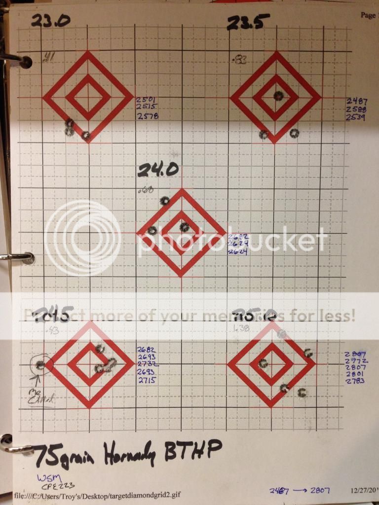

I bought a Savage VT-11 because I heard ALL the statements those Savages really shoot. Well it did! I am very happy with it! The 55 grain shoot about .5-.7 the 75 gr HPBT shoot about .7-1.0
So I bought a Savage Model 12 LRPV in .223 with the 1-7 twist. With the 80 Berger VLD at 2810 fps is has about the same ballistics as my .308 with the 175 SMK but half the cost to shoot and maybe it shoot less than .5 compare to the .308 mostly under 1 MOA. I have only had the LRVP for two days and started with load data from previous owner.
Here are the groups from the VT-11
Here is the 12 LRPV
bottom two VT-11 top LRPV
So the VT-11 is a $599 list gun the LRPV is a $1400 list gun just was expecting more. The previous owner is also offering up the Redding Comp Type S dies, maybe I need more neck tension to help tighten the group up... any thoughts or something I did not notice on the groups?
