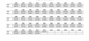

Found the right rings and turned the rear base. Looks like it's going to work. Anyway to know year on manufacture by the SN?
