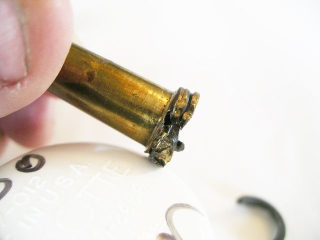

The case in the picture is a classic example of case head separation, case head separation happens when the case head separates from the case body, no one ever ask; "How does that happen?" If it happens to me it is caused by the case locking onto the chamber when fired with clearance, if the clearance is between the shoulder of the case and shoulder of the chamber the case can not separate: But if the clearance is between the bolt face and the case head expect the case to stretch and or separate between the case head and case body. The case pictured was fired 3 times.
And then there is that thing with stretch and or flow, or is it both? I have fired many rounds that got longer from the shoulder to the case head, when that happens I expect the neck to get shorter from the shoulder/neck juncture to the end of the neck. The one thing I do not want to happen to the neck is stay the same length, if the neck stays the same length I can count of the case stretching between the case head and case body.

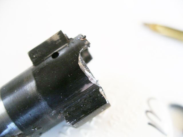

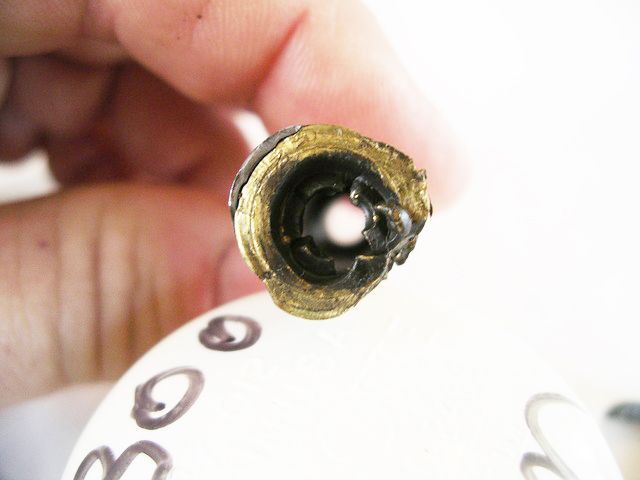

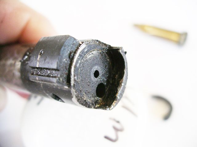

I can't speak to other actions... but this is a Remington 700 action in 22-250, and the owner intended to load a Hodgdon ball powder. Bad habits were the cause. Powders were just put on the same shelf in no order. Both were the little black 1# jugs, and, what the hell, almost all ball powders look the same, right? So he picked up a black jug of pistol powder instead of rifle powder.
22-250 loaded with pistol powder.
The bolt lugs and and the receiver lug abutments were fine, and headspace did not change. If the owner wanted to use a cleaning rod for an extractor, he could have used the action after it was cleaned up.
The shooter was shaken, but uninjured.
He got a new bolt and replaced the barrel... the rifle is currently in use.
He now keeps pistol powders in a different place in his loading area.

I saw the whole rifle first hand and I can assure you there was nothing forgiving about stuffing a .308" bullet down a .264" bore! The stock was a completely killed, the bottom metal looked like a propeller, the bolt was locked up with what was left of the extractor sticking out. The barrel had to be unscrewed to get the action opened up. The only forgiving part was the guy got away with only a few scratches and a new pair of underwear.
