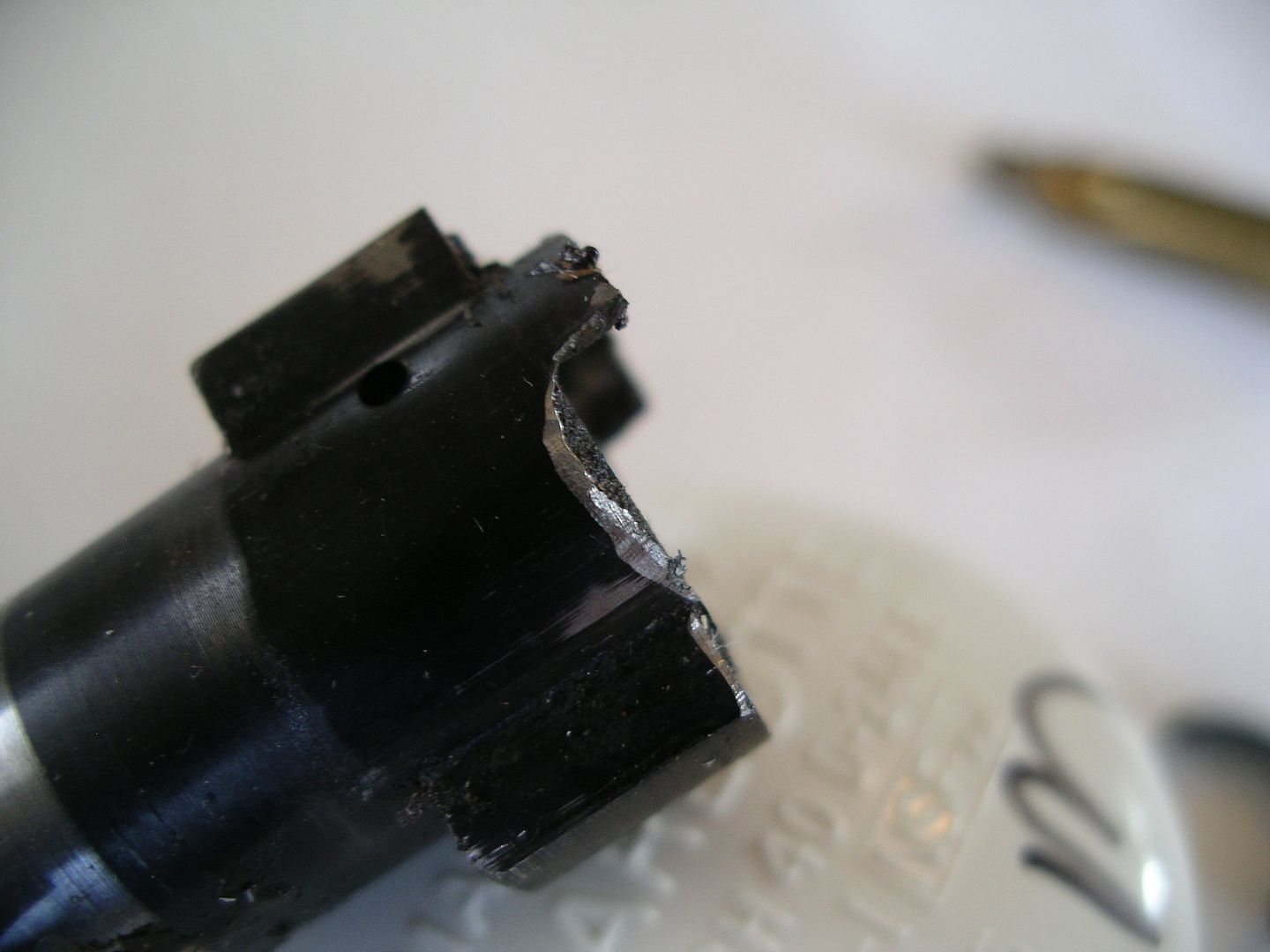

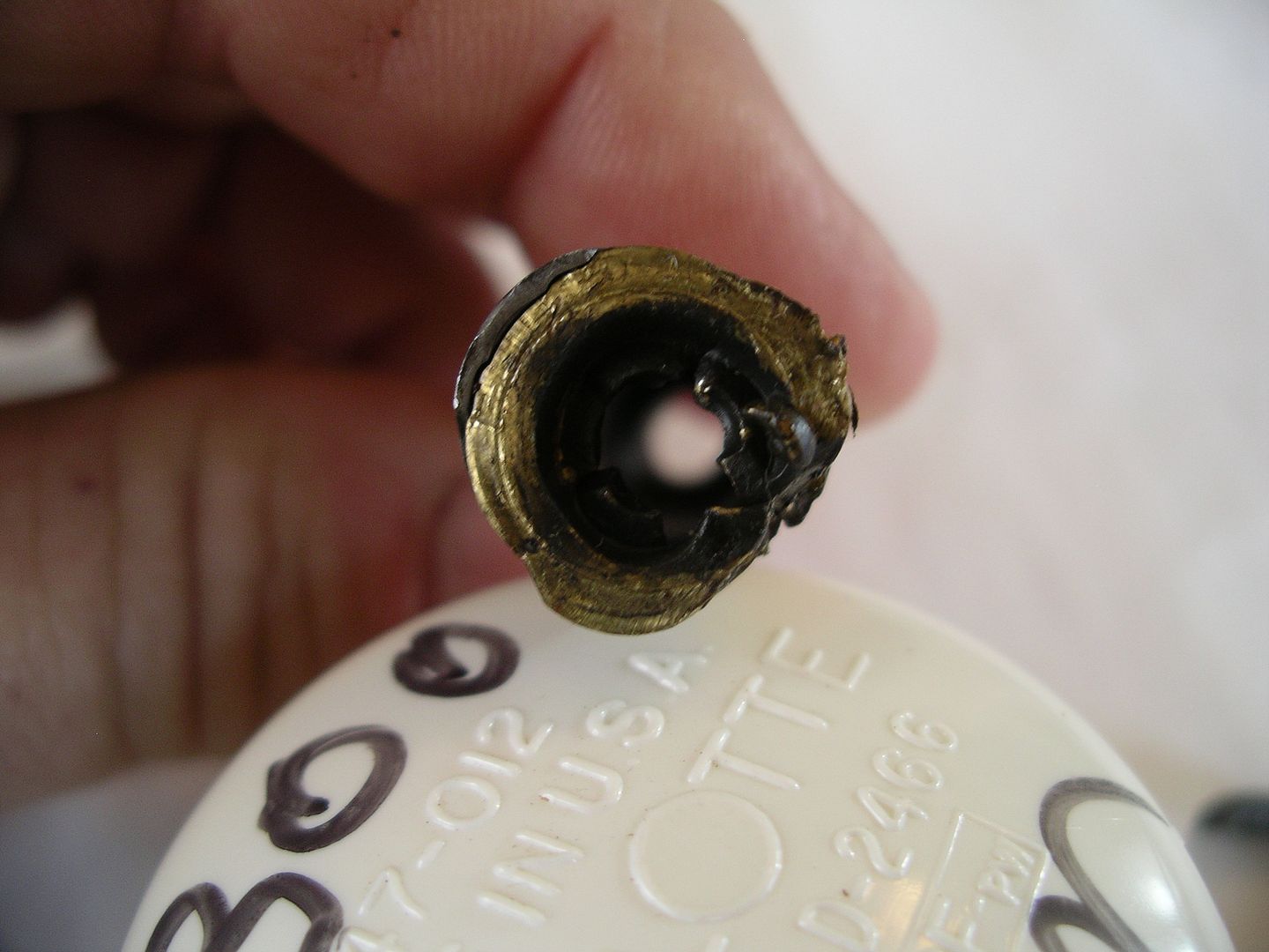

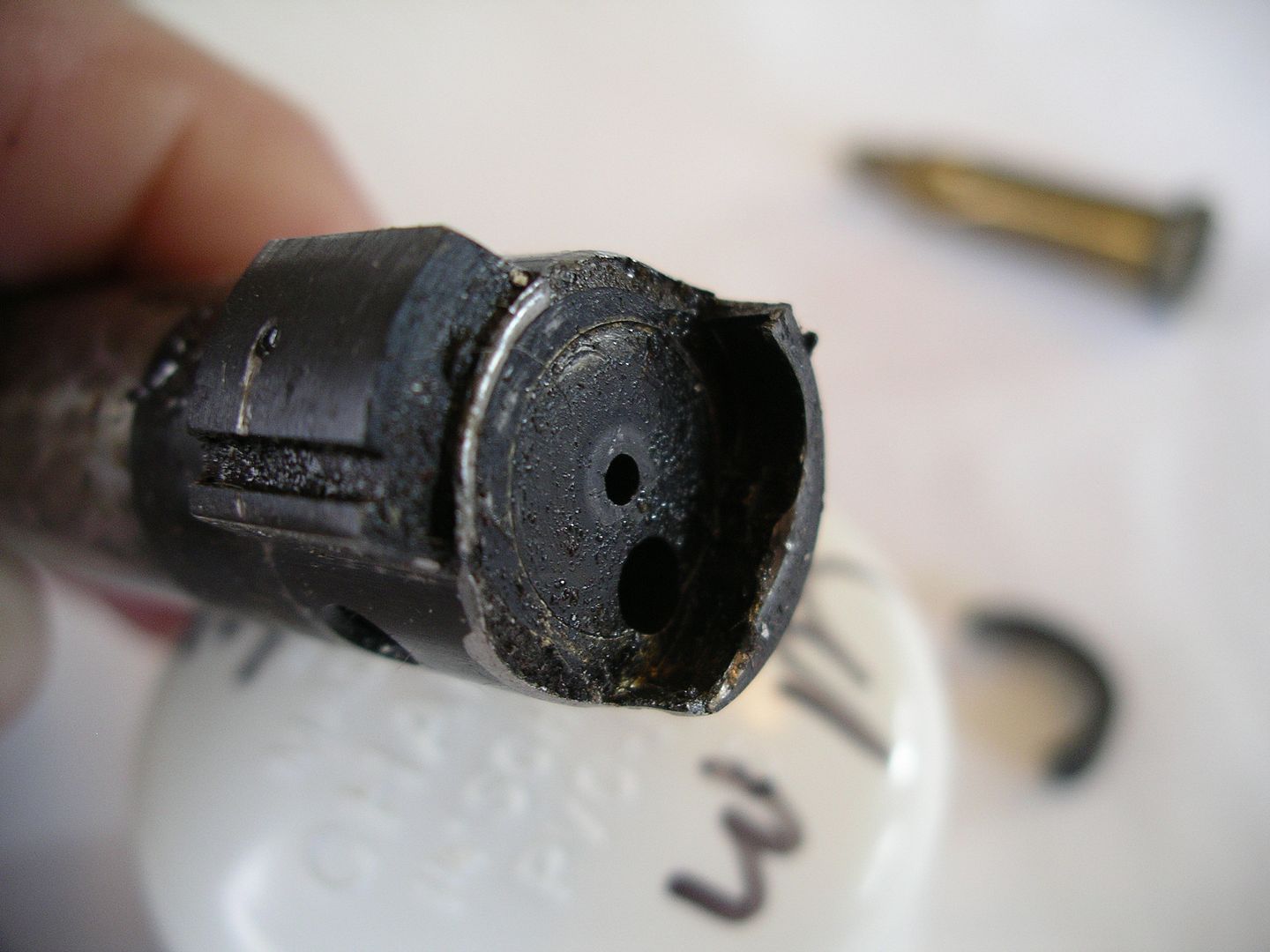

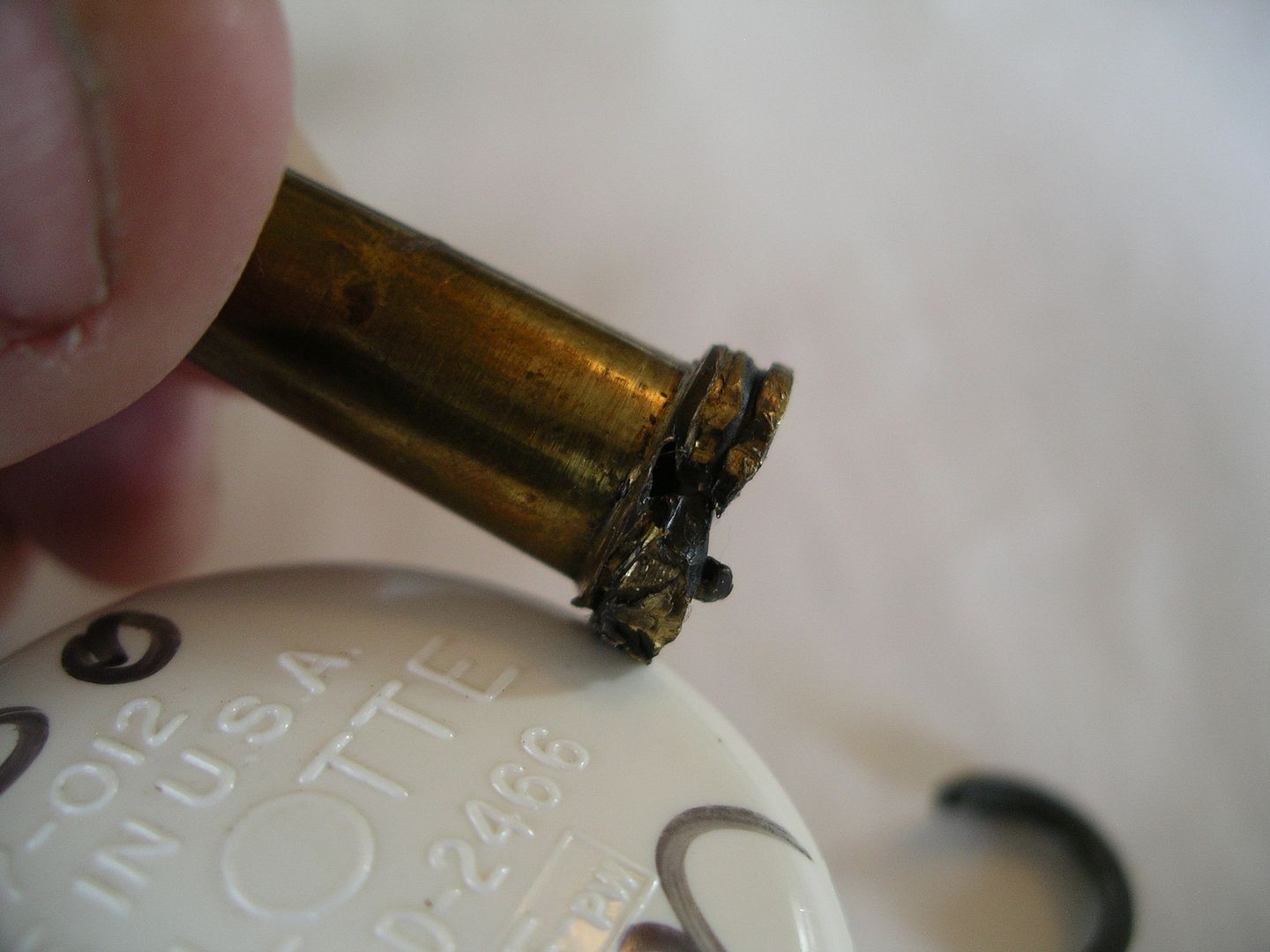

Long story, short. A good friend was dying of COPD. He was teaching his 11 year old grand son to reload. He set the powder charge 10 grains too heavy of 3031 over max load, 55g Speer in a 22/250. This was fired in a J lock, rem 700 action. The child fired the round, gasses came out everywhere, scared everyone. The child was not wearing safety glasses and there were no metal cuts nor debris in his eyes.
They brought the gun to me after his death, wanted me to sell it for them. I gave them $250 for it as it was a laminated Varmint version. I bought a new bolt for the gun, now a Dasher bbl is screwed in the action. When I unscrewed the barrel, the bolt nose came off in pieces, real scarry stuff.
Bolt nose
Bolt nose
Case head with extractor welded to the rim of the case
case head
Brass and piece of the bolt nose
