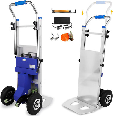

There's stair climber handtrucks
I haven't used one myself so don't know if they also run backwards.
Regardless, they'll def handle the weight, and I'm sure you could resell it afterward
