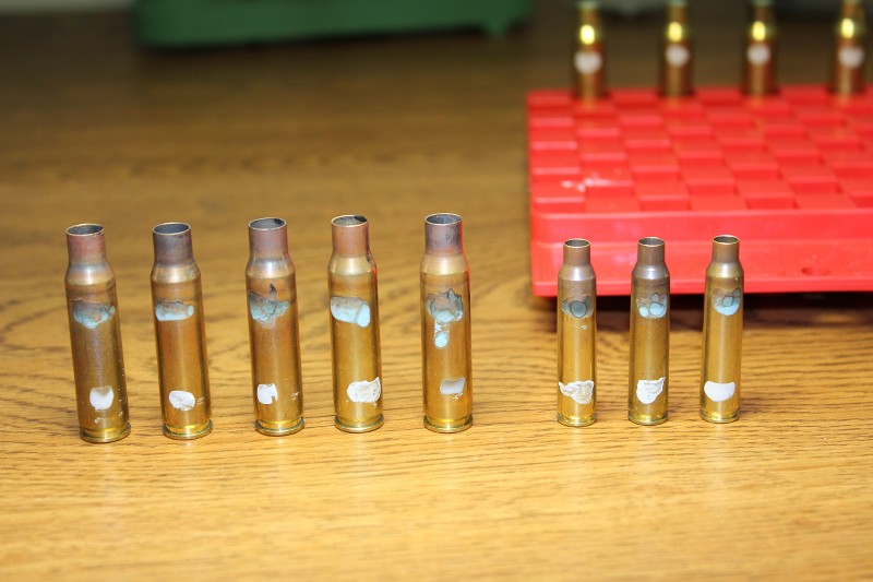

I did some limited testing using the torch and socket method . All these cases have 750* tempilaq inside the necks and 450* just below the shoulders .
I found that you can over anneal in the fact I did not have much bullet hold after over heating the necks well past 750* . I could manually push the bullet deeper into the case with minimal pressure by pushing the tip into my bench . If you single feed or from a mag on a bolt gun that may not be to bad . How ever if using an auto loader , that light bullet hold could result in bullet set back upon chambering . Maybe during recoil with the bigger cartridges .
Because of that conclusion I've also concluded that it's almost impossible to over heat the head of a case if only heating the neck and shoulder .
I ran this test by applying 750* temp indicator just below the shoulder and a 450* indicator at the head of the case . This was done on 223 and 308 cases .
As you can see most of the cases did not reach a high enough temperature to melt the 450* tempilaq at the head . All these cases were heated to the point of melting the 750* below the shoulder which resulted in all the necks glowing bright red for seconds ( at least two ) . After this test I concluded that heat migration is not an issue if the heat source is applied correctly to the neck and shoulder area only . When done correctly if your heads heat up enough to ruin the brass your necks were well over 1200* ruining the case anyways .
