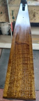

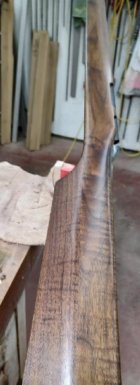

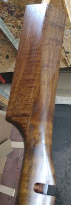

That’s the way I prefer it, both in the color of the wood and the satin finish. Very classy!
I've got a pretty nice Cerrus(sp) here that I've gone back and forth on. I like satin on some but I've done this one both ways and still not sure which I like better on it. I'll post pics when I get it finished. Needs to warm up from where it is now. I can heat the paint room a bit but it was around zero this morning and I don't wanna take a chance on it just yet.
I’ve always felt like a satin finish feels warmer - more inviting and comfortable to touch. A glassy polished finish loses the feel of wood.
All my stocks are a satin finish because it feels nicer to me and I spend as much time touching my stocks as I do oogling them :)
