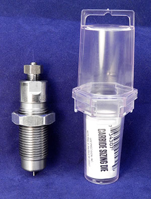

I believe that a 45ACP carbide sizing die has also been a recommended fix to try…
Apparently it allows the case to be inserted completely through the die and thus sizes the “200” line that normal dies just cannot touch… Even the “Small Base” ones.

Not positive this will work, but it's a cheap option (maybe).
Supposed to be 0.003 undersized.

Yes a 45 ACP Die works
